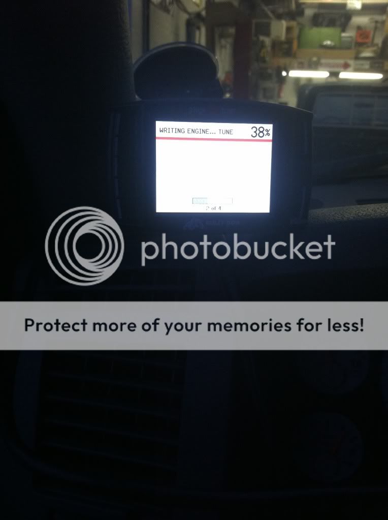

6 months later and I'm finally getting somewhere with this thing
Stopped at my buddies shop, pulled his predator off his 06 and put the bully dog on it
And it worked! I was pretty surprised how quick the tune installed
He offered to trade me his predator (which I'd have to sell since its for 06-07) and a gauge pillar with automated boost and perimeter gauges and $75, I think I'm going to have to do it since I don't feel comfortable selling it online to somebody and not know if it'll actually work on their truck.
I'm kind of bummed though, I really really like this tuner now that I've used it. I'm on the fence if I should try to get another one and see if it will work, I hate to get stuck with another one
