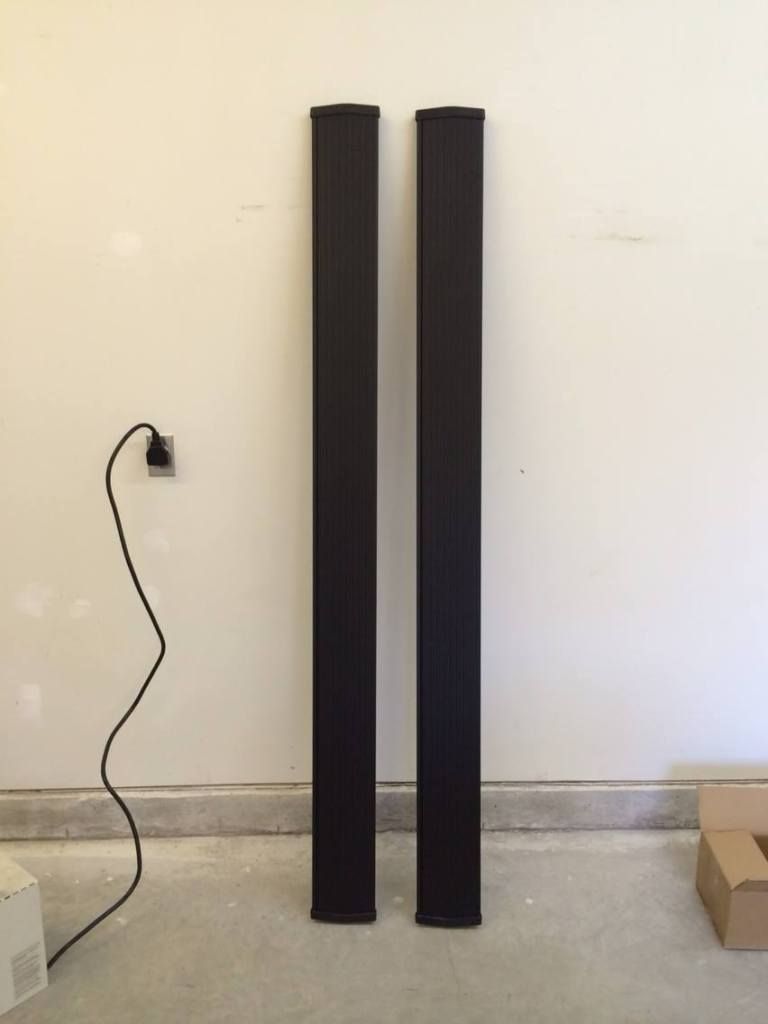

So I finally have another actual mod done to the truck that I can post up about. AMP Powersteps! I knew right from the get go that these would be going on the truck eventually simply because they'll be needed to get into the truck once it's 12 inches higher and I'm really not a fan of the look of running boards. So these steps are the perfect option.
Background:
I was originally going to buy the steps from Bully's Performance and had a price quote on them and was ready to order. But when how much the Canadian Dollar has dropped lately I figured it might be worth it to do a little research from Canadian dealers to see what kind of pricing I could get them for locally. I ended up finding a place in North Vancouver that had them in stock and could do them for only $10 more than what Bully's had quoted me. With that little bit of difference it literally saved me about $100 buying locally because of how low the dollar is right now. I definitely struggled with that decision since I love supporting Bully's Performance and dealing with those guys... but when we're getting into savings of $100 or more it just made sense to buy locally.
Install:

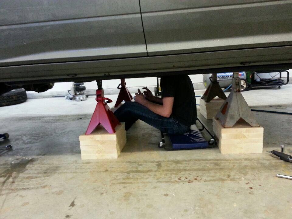

Anyways... about the install. I picked these up Friday after work and had them on by Saturday evening. I had a lot of work to do before hand seeing as all my tools and garage equipment was still packed in a trailer from when we moved. So first thing was unloading the entire trailer to get all my stuff (yes my tool box was at the VERY front of the trailer). Once I got that done I started getting things set up in the new shop. For now I just brought enough stuff out there to get the steps on so it looks a little bear. We have some big plans for the shop yet but I won't get into that right now. If you want to know, ask about it and I'll answer in a separate post.
I started by jacking the truck up as high as I could (obviously...) and then laid out everything on a table to make sure all the parts were there and to have easy access to them.
Because my truck came with factory steps on it the rivnuts were already installed in the front and back slots of the truck which reduced the amount of work I had to do slightly. However, since I plan on putting a BDS long arm lift on the truck fairly shortly I knew I needed to move the front bracket back far enough to clear the long arm bracket. I had done a bit of research online and watched a couple youtube videos to find out exactly where I needed them. If anyone is interested in seeing the video let me know and I'll post it up. I installed the front brackets two slots back from the front in order to give me enough clearance. I used the reinforcement bracket that came with the steps to mark out where I needed to drill the holes for the new rivnuts and then used a step bit to drill two 9/16" holes for them. I then installed the reinforcement bracket and riveted that in and then installed the two rivnuts. From there you need to use a template the comes with the steps to drill two holes for each bracket in the pinch weld of the truck. Just for extra reinforcement to keep everything solid. After that it takes a bit of messing around to get the brackets slid onto the bolts, in the proper place, and lined up.

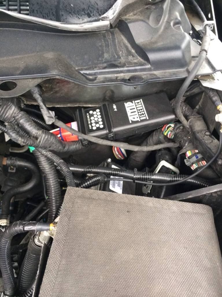

I then grabbed the wiring harness and started running it down to each side of the truck from the engine compartment to make sure I had enough slack in it after moving the front mounts. I then drilled the holes for the LED light wiring and installed those and then wired everything up and tied it up to the frame and in the engine compartment. From there I installed the boards themselves onto the brackets.
Wiring up the steps in the engine compartment is very straight forward and the harness they provide is very good to reach everything. I tapped off the positive on the battery for power and used the factory ground behind the battery for the harness ground. Then I removed the TIPM to get to the connector with the "door ajar" wires on it. When you pull out the TIPM is the connector on the bottom passenger side of the module. Unplug it and pull it out to get at everything. The kit comes with 4 wire taps to connect the wires and everything is colour coordinated; you literally can't screw it up it's so straight forward. Then I put everything back together, installed the fuse in the main power line, and plugged in the control module.
Then it was time to test out the steps. The passenger side worked flawlessly but the drivers side wasn't retracting all the way. At first I thought the motor might have been turned too far one way and didn't have enough movement in the other direction to bring them all the way up. So I took the motor off, opened the door to put it all the way down, then reinstalled it on the extended step. Still didn't fix the problem. So then I decided to push on it a little bit when it was closing to see if it would go up. Sure enough, it did. So I tried it again only using a finger, and it still did. So I concluded it much just be something slightly misaligned and the safety feature on the step is stopping it thinking it's hitting something. Sure enough the rear bracket was at a slight angle. I loosened it off from the step and tapped it over a bit with a rubber mallet and that fixed the problem. Everything worked great!
I then got back under the truck and drilled out the body through the holes in the top of the brackets to install the last rivets and then went through and double checked all the bolts to make sure they were tight.

So here's the final product!
Steps retracted:
Steps extended:

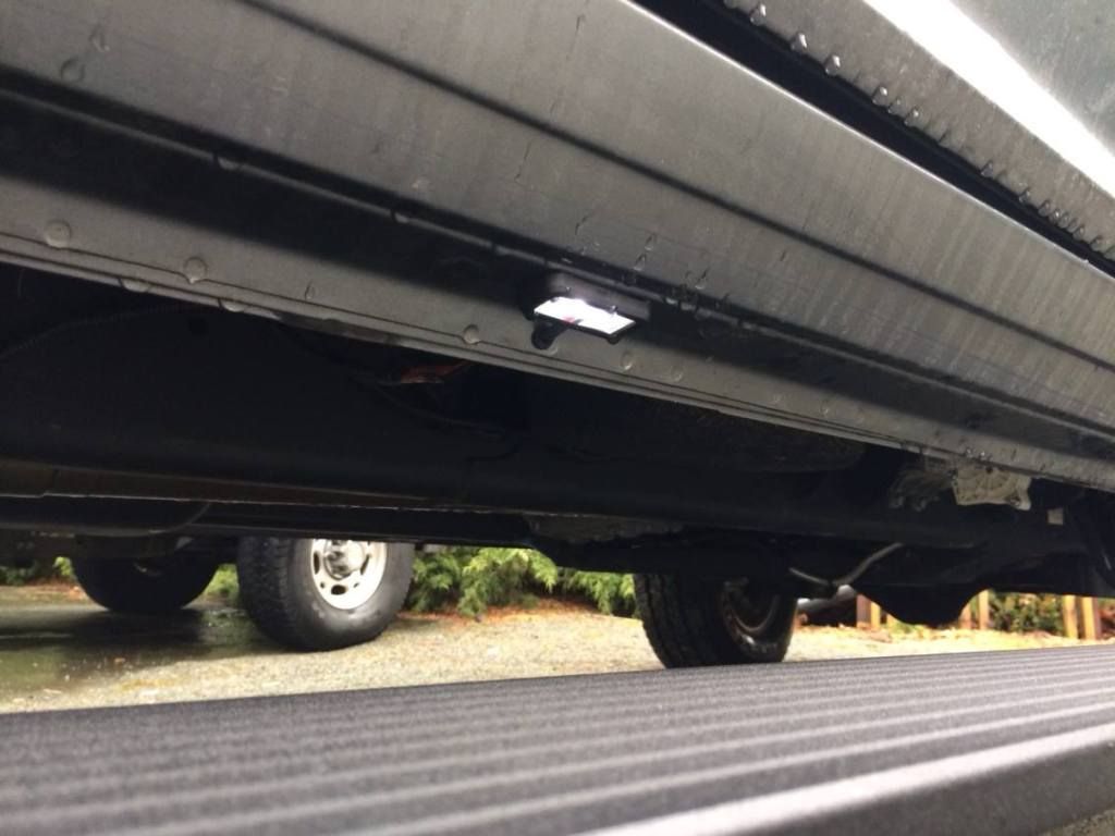

LED lights:
Showing how far out they extend:

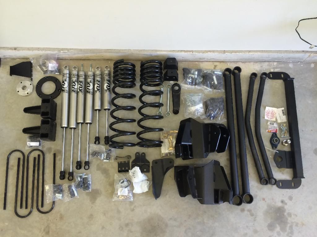

Default Picked up the Lift 4-9-14

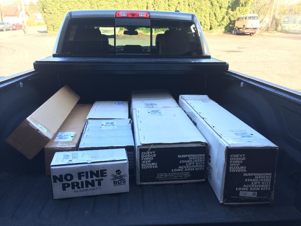

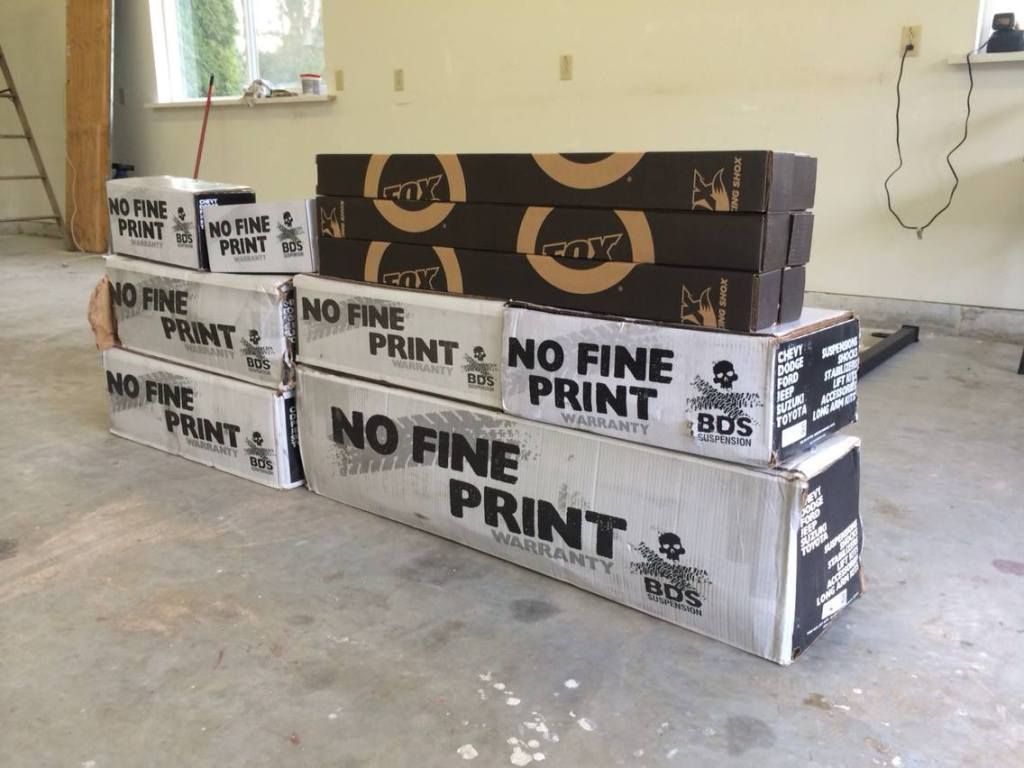

Picked up some goodies today. Here's some teaser pictures for you guys.
Everything in the back of my truck:
All the boxes unloaded on the shop:
6 Fox Shocks to go on the truck:
All the goodies:

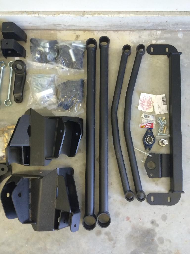

Steering box stabilizer, front long arms and brackets, drop pitman arm, front bump stops, front sway bar links and all the hardware:
Progressive rate 8" front coils, track bar drop bracket, steering stabilizer hardware, steering stabilizers, front and rear shocks, rear lift blocks and U-bolts, transfer case indexing ring, front driveshaft spacer, rear brake line bracket:
Shock porn

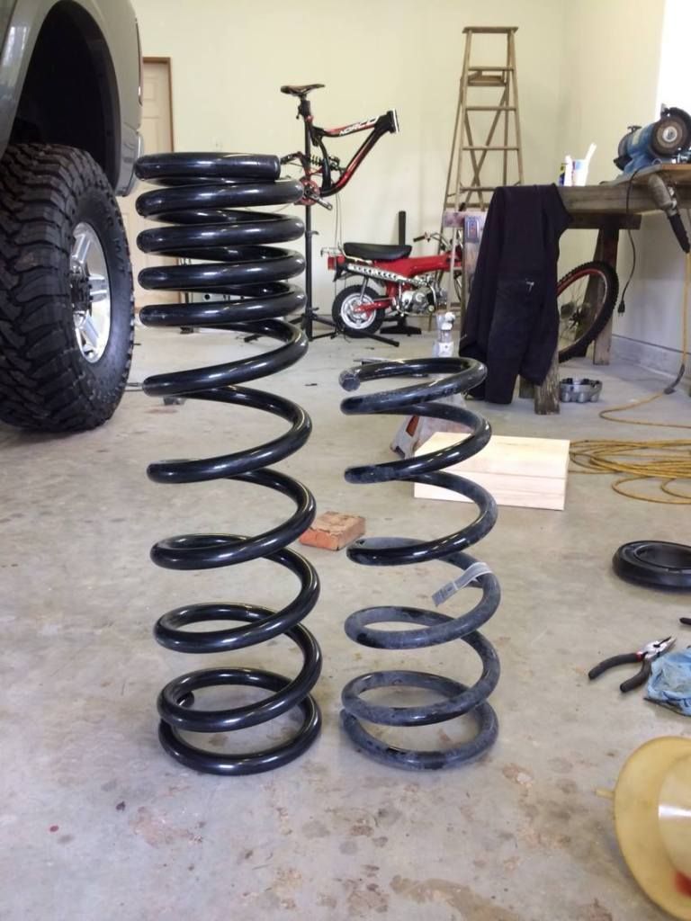

First off I need to say thanks to Eric at Bully’s Performance for the countless emails him and I have sent back forth regarding the lift and components dating back to January. He was always very fast to respond (I generally had a reply within half an hour of emailing him) and was very cooperative in working through some of the custom setups and different ideas that I had. I’m very happy with the service he provided (along with the rest of the Bully’s Performance team) and the product(s) I ended up with.
Products:
• 8” BDS Long Arm Lift with Fox 2.0 Shocks
o 8” progressive rate front coils
o 5” rear blocks
o Transfer case indexing ring
• Dual Fox 2.0 Steering Stabilizer
o BDS dual steering stabilizer mounting kit
o 2 – Fox 2.0 shocks
• Hell Bent Steel Steering Box Brace
• Motorsport Tech 2” B.O.R.A. hub centric wheel spacers
• 37x13.5r17 Toyo Open Country MT’s
Technical Info:
• Stock Heights:
o 38.875 38.875
o 42.000 42.750
o Roof: 78.875 (6’-6 7/8”)
• 8” Lift with 37’s Heights:
o 49.000 48.875
o 50.125 50.000
o Roof: 88.000 (7’-4”)
• Poke (past the flares - add 1" for past fender value):
o 2.5” 1.5”
o 2.0” 2.0”
Installation:

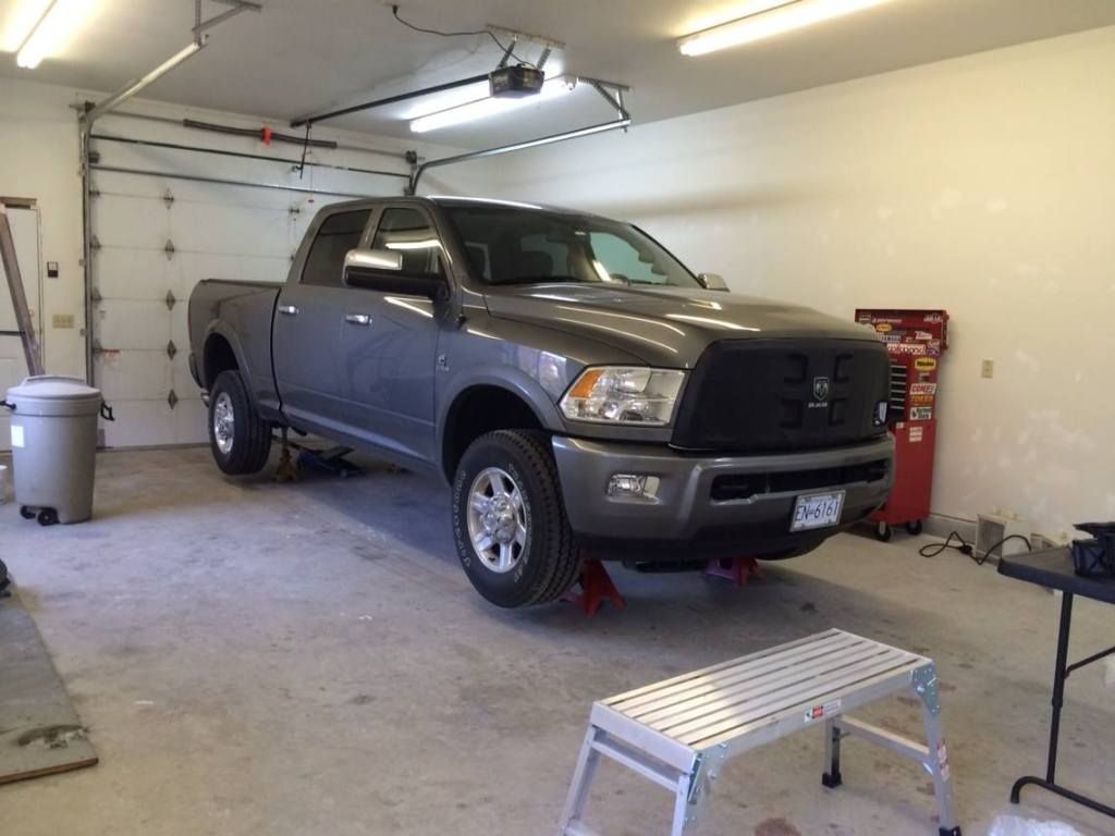

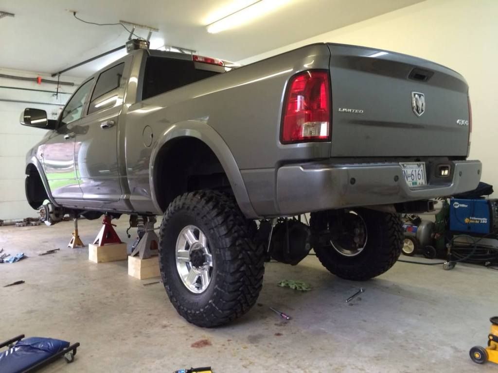

I started on the install Wednesday night (April 16) as I had Thursday and Friday off work as part of the Easter long weekend. I had started some of the prep work the few days prior to get the shop temporarily set up to install the lift (we don’t have our shop fully up and running yet as we just moved into this house a few months ago and have some reno plans for the shop before we fully set it up). So I had enough tools and equipment in there to get going. Obviously the first step was getting the truck up on jack stands as high as possible. I built some blocks out of 2x12’s screwed together to gain the extra height I wanted. You’ll see in the pictures that I also had to use a number of blocks on top of the floor jack in order to reach the truck.
Transfer Case Indexing:
We started by pulling the wheels and tires off and then decided the first task at hand would be installing the transfer case indexing ring which rotates the transfer case 10 degrees down for a better front drive shaft angle. First we pulled both the front and rear drive shafts, followed by the wiring harness going up to the transfer case. We then supported the transmission and pulled the transmission cross member and cross member bracket. From there we loosened off all the transfer case bolts. One of the top ones is definitely not the easiest to get at. I ended up getting it with a swivel head ratchet wrench but it wasn’t easy. We then hand bombed the transfer case down and out of the truck (do-able if you have two strong guys but you won’t want to be supporting it for a long amount of time). We removed all the studs from the transfer case by tightening two nuts together on each stud and then installed the indexing ring and studs with the supplied hardware and red Loctite.
I then got back under the truck and pulled the rear transmission seal, put in the new seal spacer (fits right into where the seal came out of), and then installed a 48rfe rear seal into the backside of the spacer. From there we hand bombed the transfer base back up into place, threw the nuts on and tightened it up and called it a night.
Rear Lift Install:
Thursday I was by myself for the majority of the day (as my friend at to work) so I decided to tackle the rear lift since that’s something I could do alone. I started by removing the rear diff vent, brake line bracket, and shocks. I then removed the U-bolts from the passenger side, dropped the rear diff down and installed the 5” lift block, and then installed the new U-bolts just snugging up the nuts. That process was then repeated on the driver’s side. Installing the new Fox 2.0 shocks on the back was a bit of a task as they don’t like to compress very easily… I ended up having to use a pry bar and a long screw driver to compress the shock to get the lower mount into place and bolted up.
At this point in the day I needed to go take my stock wheels and tires to the shop to have my new 37x13.5r17 Toyo MT’s mounted on them (I already made the arrangements to have the tires there waiting). While the tires were being mounted and balanced I ran down to Sumas, WA to pick up my wheel spacers as they had just come in that morning. I then went back to the tire shop and picked up my wheels and tires. They were able to balance them by just putting weights on the backside which I was happy and surprised about. I wanted to keep weights off the front of the wheel if possible (just because it looks better) but I didn’t expect that to happen with these big tires.

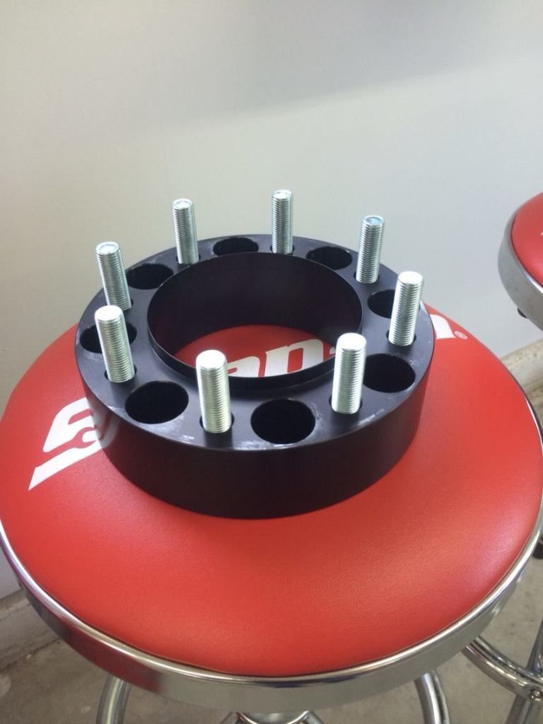

When I got home I ran into the first problem of the install…. The wheel spacers didn’t fit. So I got out the tape measure and sure enough, they were the wrong bolt pattern. I contacted Lenny and Motorsport Tech right away to talk to him about the issue. What ended up happening is that two shipping labels got mixed up so I got spacers for a Ford and that guy got mine. It’s ended up being quite the hassle getting the proper spacers; if you want to know the full story check out posts #473-517 on my build thread.
continued on post 27...

Anyways, I continued on by throwing the wheels on the truck, letting it down onto the tires, and then tightening up all the U-bolts. I couldn’t get them to an exact torque since they protruded through the nuts too far for a deep socket. So I used the double wrench method for more leverage and got them as tight as the stock ones came off; good enough for me.

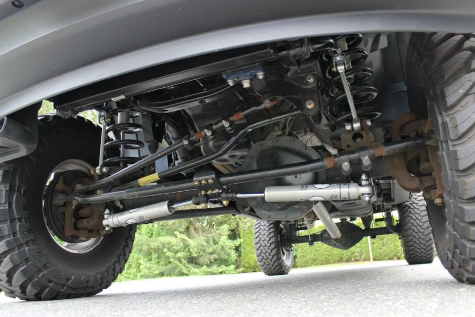

Front Lift Install:

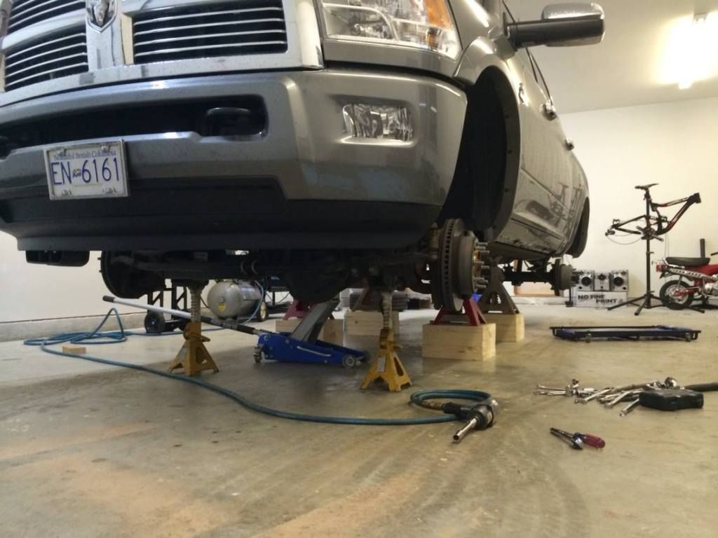

Around 7:00 my friend showed up so we started working on the front install. We started by putting the long arm brackets up into place so we could mark the holes on the frame and drill them out. Getting those heavy brackets up in place and getting the bolts through was no easy task… At one point I dropped one back on myself and took a good chunk of skin/flesh out of my elbow blocking it. We ended up having to use the floor jack to force them up in place and drive the transmission cross member bolts through. From there we marked the holes, took the long arm brackets back off, center punched the holes, and then drilled them out to 11/16” with a step bit. I then went to install the 8 rivnuts in the frame and transmission cross member. Here’s where the problems started… First off BDS didn’t supply a bolt specific for installing the rivnuts; they expected you to use the bolt that actually holds the bracket on. Well those bolts aren’t really long enough for that, they don’t grab all of the threads through the washer and install nut. But I didn’t have another bolt that was the right size and thread so that’s what we had to use. I installed all 8 thinking they were good to go so we threw one of the brackets up there to bolt it on and sure enough, the rivnuts started spinning. So we tried tightening them up a bit more, wasn’t happening. No matter what we did we couldn’t get the rivnuts to seat. So by this point I decided we were going to grind some of the paint off the frame and tack weld the rivnuts to it to stop them from spinning which should let us get the bolts tight enough. So we did that and tried to install the bracket again. We then found out that the threads were too stretched out in a few of the rivnuts because of the install bolt being too short. I tried running a tap through them and managed to fix 2 of them but another 2 were too far gone. So we got out the grinder and ground the outer flange off two of them and took them out. I had one extra one that came with the kit but I needed one more. By this point it was around 11:15 at night so we called it quits.
Friday morning I went out to see if I could find another rivnut to install in the frame. Being Good Friday none of the big industrial supply shops were open and no automotive shops had anything near big enough. So I was SOL there… I ended up getting a piece of ready rod so we could make our own custom rivnut install tool so that we didn’t screw up the threads on the extra one I had. So I went home and grabbed my Dad and he and I started going at the truck again. We got the extra rivnut installed and tack welded to the frame and then put a coat of paint on the frame and rivnuts where we had ground it off. We then grabbed the long arm brackets and went to put them up on place. Again we had to use the floor jack to get the big cross member bolts through them. Then once those were in place I went to put the side ones into the frame. There were a few of them that weren’t lined up 100% (I’m assuming the bracket wasn’t sitting in quite the same place as it was when we marked the holes) and I couldn’t get the bolts in perfectly straight. So I got out the die grinder to machine out the holes in the brackets a little bit to make it all work. After another 20-30 minutes or so of messing around with that they were on. Overall I’d say we had around 6-7 hours into just installing those long arm brackets. It was a pain in the ass to say the least. So yes at the moment I’m missing one rivnut on the passenger side long arm bracket but with the 5 other huge bolts holding it on it isn’t going anywhere. Eventually I’ll probably get another rivnut and pull the bracket off to install it but for right now I’m not worried about it.
From there we started pulling the rest of the front end apart. I had already unbolted the track bar before I jacked up the truck so that was done. We removed the drag link, sway bar links, and sway bar (needed it off completely to install the steering box brace later). Unbolted the front shocks and then dropped down the front diff to remove the front springs and shocks.
We then installed the new Fox 2.0 shocks loosely to help support the front diff so we could remove the stock control arms. 3 of them came off no problem; the upper passenger side control arm however, was a problem. As soon as I looked at the bolt I knew we were going to have an issue. It went through the frame right beside the exhaust with only about a 1” gap between the exhaust and frame. We got the nut off the other side no problem but couldn’t feed the bolt back through the frame all the way to remove the control arm. So out came the die grinder again, this time with the cut off wheel on it and we cut the head of the bolt off so we could push the bolt back through the other way.
Installing the new control arms ended up being a 3 person job (luckily my step brother showed up for a bit to give us a hand). We had one guy holding the control arm and lining it up with the hole, one guy pulling or pushing on the front diff to help line it up, and one guy pushing up on the pinion to rotate it to the right angle. It was one of those things that took a lot of effort and a little time but overall went together really smoothly. From there we dropped down the front diff again and removed the shocks so we could install the new front coils (along with the shocks). We then installed the Hell Bent Steel steering box brace along with the front sway bar, the new drop pitman arm, the new sway bar links, and the track bar drop bracket. Again, all of that went together no problem. We then removed the stock steering stabilizer and cut the brackets off the front diff to make room for the new dual setup. This is where we ran into one more little fitment issue. The brackets that BDS supplied to fit into slots in the front diff were too wide to seat properly. So out came the grinder again to start grinding off the sides of the bracket to get them to slide in. We finally got those in and bolted up, bolted up the new bracket onto the tie rod and installed the steering stabilizers. After that it was just a matter of reinstalling the drag link and track bar. I then threw the front wheels back on and let the truck back down onto the ground.
From there I just had to go through all the front end nuts/bolts and torque everything to spec. That was a feat in itself. Getting the control arm bolts to 160/180 ft-lbs while lying under the truck was definitely a task… luckily I have a pretty long torque wrench and was able to either use my full body or leg as leverage or it wouldn’t have happened.
continued on post 28

Wheel Spacer Install:
When the wheel spacers finally showed up (over a month after the lift was installed) I pulled the truck into the shop right away to get them on there. While I had the wheels off I checked over all the lift components to make sure everything was up to torque. To install the spacers I had to remove all the retaining rings that the factory puts on the studs to hold the calipers on. From there I slid the spacer on and then used the nuts that came with them along with red Loctite and torqued them to 140 ft-lbs. The wheels were then installed and torqued to 85 ft-lbs as per Motorsport Tech's specs.

I’m very happy with how the truck handles with all the new components installed. The steering box brace and dual steering stabilizers are definitely doing their job. The steering wheel feels firm and responsive and is very smooth throughout the turning radius. There’s obviously a bit of spongy-ness in the tires but that’s to be expected with 37” MT’s. Overall I like the feel of it better than stock.
The one thing that I will need to add to the truck yet (as some of you may have picked up on by seeing the front poke numbers) is an adjustable track bar to recenter the front axle. The track bar drop bracket isn’t quite enough for the full 8” lift. I’m going to BD Diesel’s Dyno Day this weekend so I’ll see if I can pick one up there.

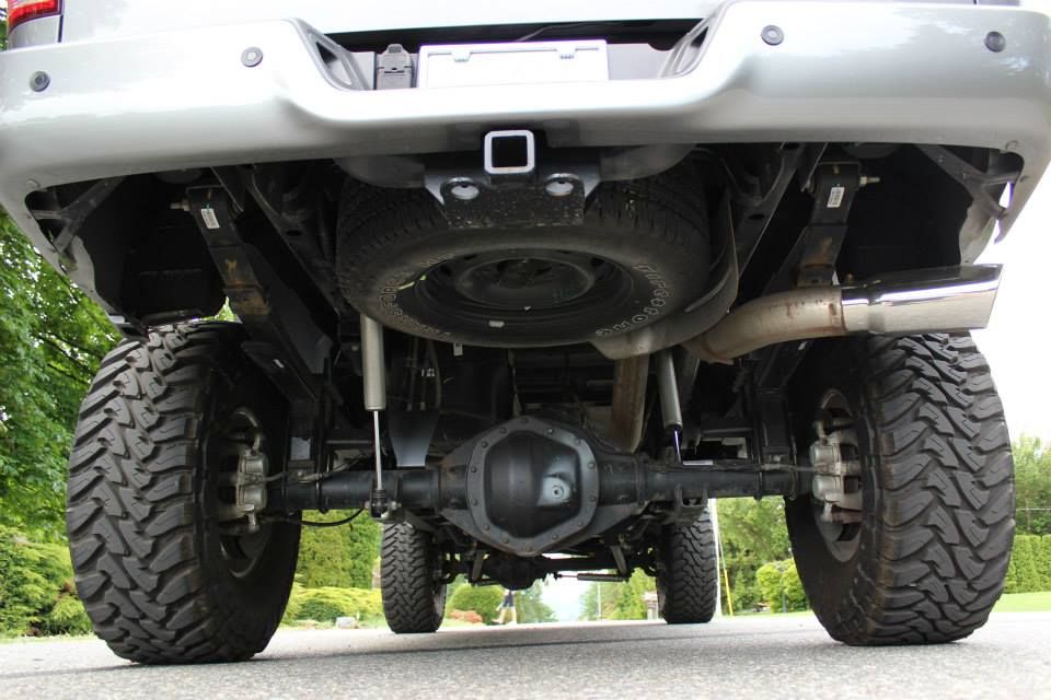

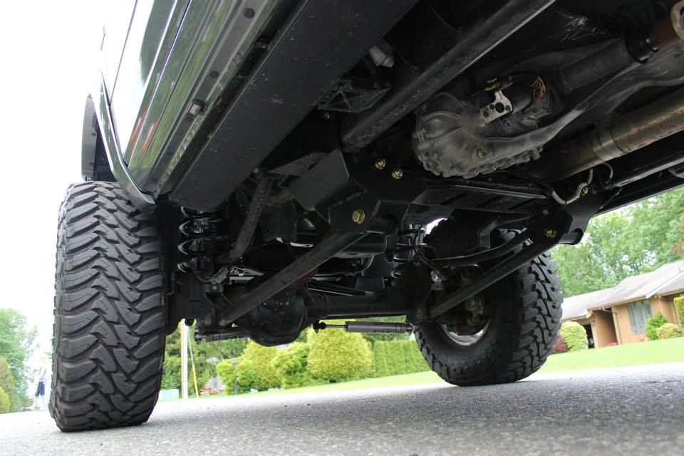

Pictures:
I didn't end up washing the truck before taking pictures since it's supposed to end up raining here for the next few days. But it looks pretty clean on the pictures anyway. Ignore any dirt/crap you see.

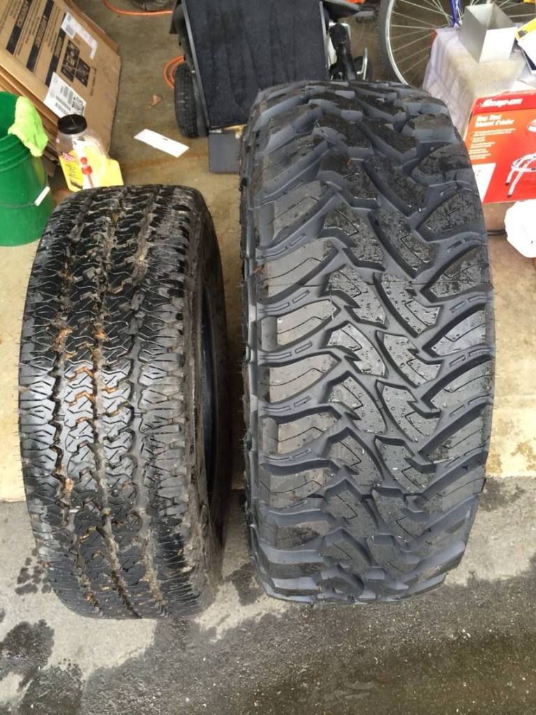

Me standing in front of it for size comparison (I'm about 6'-0" tall):
100% stock compared to now:
