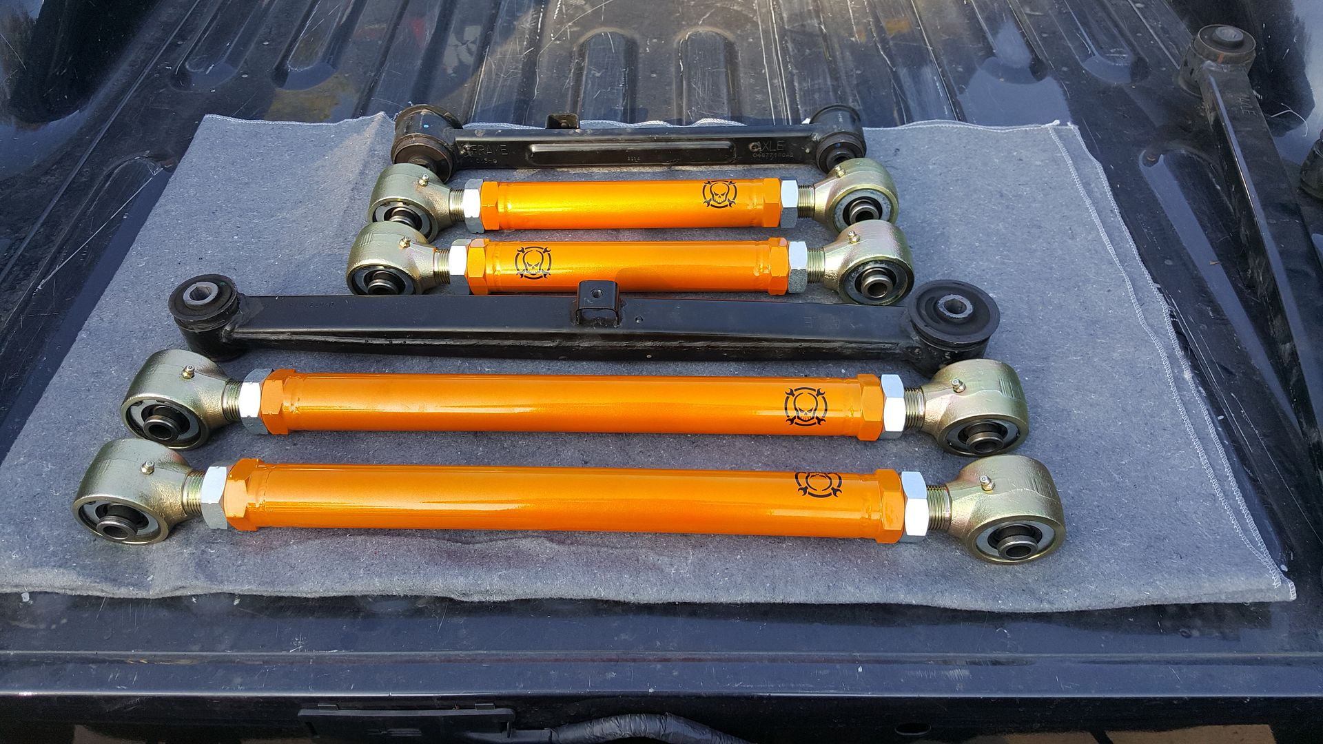

I'm waiting to see how SKWURLZ does on his setup. Much better for lowered adjustments in my opinion and no clucking or service every 1000 miles.
looks promising brother, but I'll be damned if you have to spend money twice on this

Whose arms are these?
Also, why doesn't anyone take the stock arms, cut the ends off and make them adjustable? You may not get less deflection than the Del-sphere bushing but at least you would have the correct geometry and no clunk....
