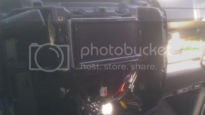

This past weekend a friend and i tackled putting in my sony 701hd. it wasnt the easiest job but it is possible for the ones out there that want to swap out the factory head. personally, to be able to never use the cd player in the bottom storage bin again made it all worth it. (pictures are garbage, actually a sunny day and all i had was my phone, sorry)

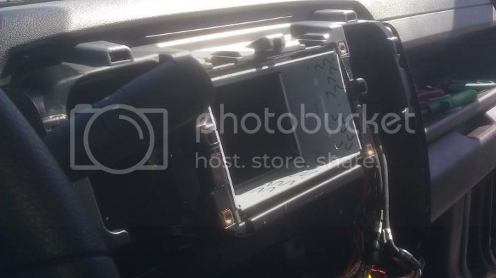

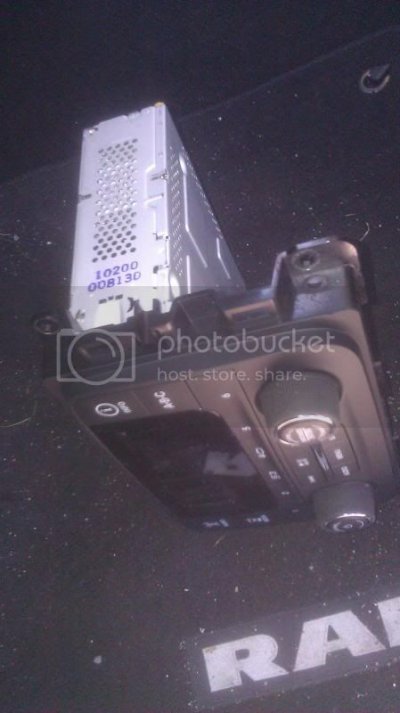

Since there are no kits available we had to rig up a mounting plate. First you have to cut out the stock bracket since the 3.0 unit is only single din
we just used tin snips on the bottome piece then rigged up the new cage in place

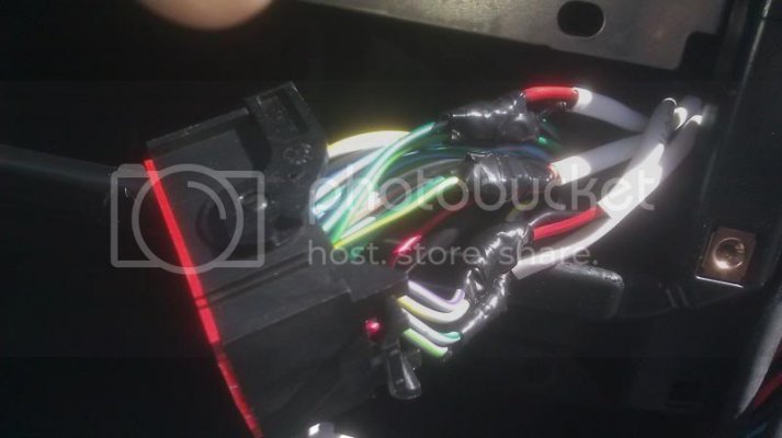

at the harness all i did was tap/soldered into the speaker lines, power/ground.IMAG0943_zps7c7416b4.jpg
I had an unused plug that i found the illumination off of by the climate plugs(just hanging free). voltage for the illumiation wire will vary from 2 to 11+ volts when you adjust the guage cluster knob. my truck has two lighter/accessory plugs up front, one constatant one key on. i soldered on to the one for key on for accessory. A multi-meter is your best friend on this job.

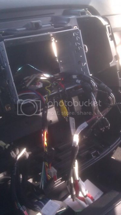

running the power is easy, just go through the grommet next to the brake booster

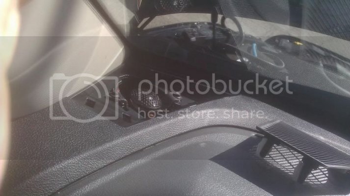

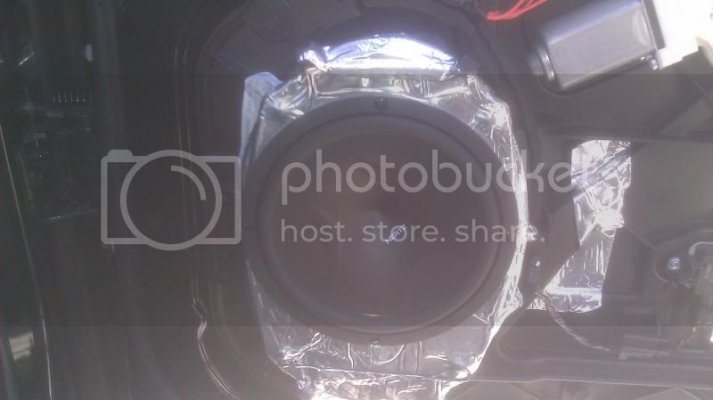

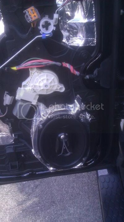

I did the speakers as well

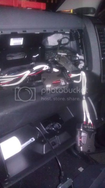

placed the crossovers under the dash

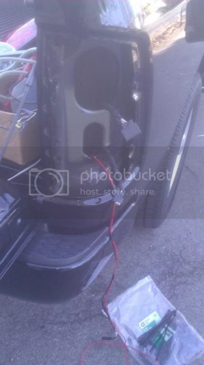

We ran a backup camera to the handle on the tailgate(guessing that is where the factory one sits from the convienent spot to put one.)
tied everything in behind the tail light

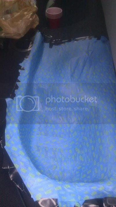

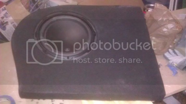

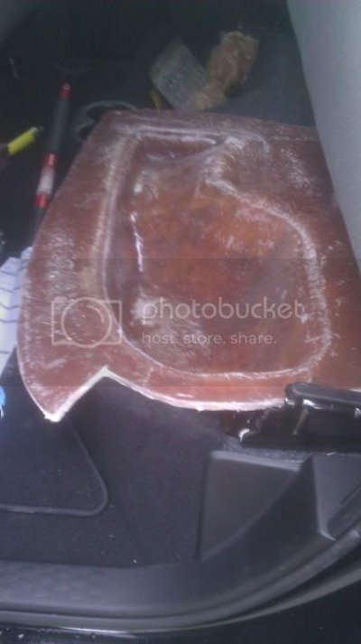

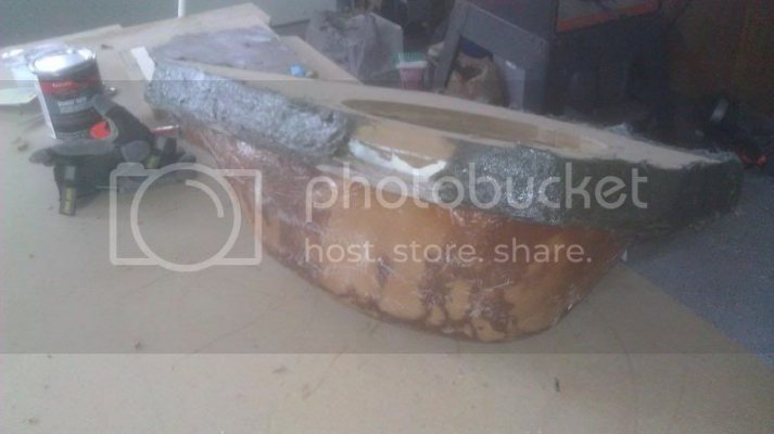

i fiberglassed my own box for a JL 10 W3v3 4ohm

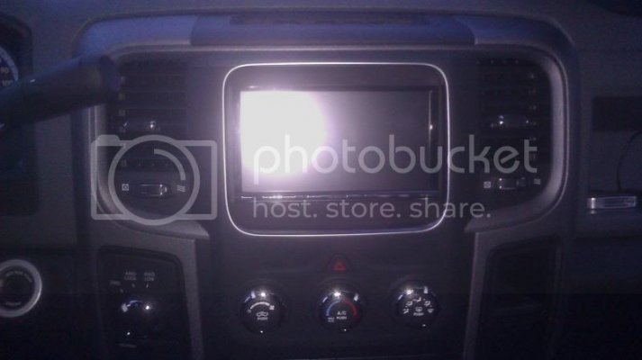

put the bluetooth mic up my the mirror and finished off the head unit by putting some flat black strips of plastic to fill out the opening with backing strips behind them.
there are two little gaps at the sides of the deck that arent noticable to anyone unless you point it out, but once a kit is made i will most likely swap it in.

All in all, i couldnt be happier with the system. it sounds amazing and looks pretty good for my taste. Not the easiest install but it is possible.

If I may, I am curious about speakers, especially in the doors. What size are the stock ones? What kind of plug?
G
Gtikid98
Mar 8, 2013
thanks guys. the doors are 6x9's all around. i went with a 6.5 two-way system in the front so i could replace the small dash speakers with tweeters. i just used scoche(think thats the brand) speaker plates to change it up.
the plug is a standard factory two wire socket type(male/female). i just soldered jumpers to the new speakers to retain the factory clips.

Nice work!! That install looks very clean? Is the fiberglass bowl shape factory or did you make a resin mold out of the empty cavity to fit your application Very nice install
G
Gtikid98
Mar 8, 2013
i made a mold then cheated a bit and went to my cousins(boat builder) and used his chop gun to beef it up a bit :p That made short work of the Box. capped it with MDF and cleaned it all up. The box hits way too hard for my aging ears so i hardly turn the sub up lol.
If i did it again i wouldnt of rounded off the front edge, i would have made it more angled like the pocket. i just got ahead of myself and im nit-picking...it really doesnt bother me at all.

Really like the install. Is that just a standard double din cage you used in the dash?
