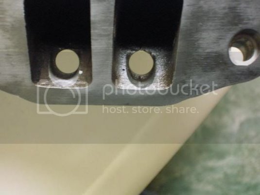

The first thing I did was to mark and cut the runners. On a 5.2, 1"-1.25" off the runner is considered by many to be appropriate. On a 5.9, you can cut the runner all the way down. Here is the mark I used as a guide. Use a sharpy and a straight edge to make your marks. Notice that I decided to make my cut at an angle to the existing opening edge of the runner. This opens up the runner more to the center of the plenum space, but keeps the backwall of the runner almost at its stock length. Another possible way is to make your cut parallel to the existing edge of the runner. Doing it this way would keep the opening direction of the runners the same as they are from the factory. It is up to you how you want to make the cut. No one has done enough testing of this mod to now yet which way works the best.
4) I then used a sawzall to cut the runners. I recommend using eye protection and even ear protection as you cut. It is very loud, and small slivers of aluminum can fly up. Cut slowly, so you do not overheat the blade. Use a blade rated for metal 3/16"-1/4". Be very aware of your blade as you cut. It is easy to cut up the belly pan mounting surface if you don't watch were your blade is. This could cause oil leaks into the plenum later. Also be aware of the clearance around the tip of your blade. As you can see, the cut is not quite in line with my mark. This is because the angle of my line was too sharp for the sawzall. I would have cut into the belly pan mounting surface if I had stayed on my line. You can leave it like this, or get back on your line using other smaller cutting tool (Rotozip, Dremel, or even a hand file for example). As you near the end of your cut, slow down so that you don't bust through the cut and hit your blade on something you didn't intend to.

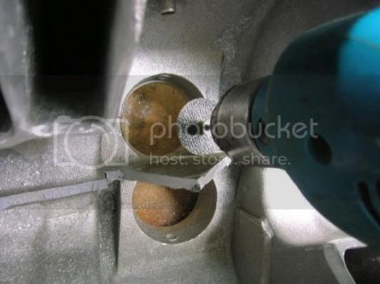

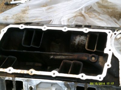

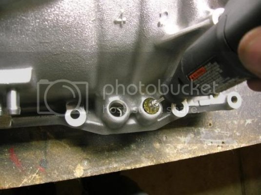

7) If your intake has the center divider, it is time to remove it. Chrysler engineers figured out after a few years that the removal of the center divider promoted better air flow. Most '99-'01 intakes do not have the center divider. Since the intake I am modding is a '97, it has is. First, I tried to use a dremel to cut along the bottom. Even though this was easy to do, the blades broke very easily and did not make much progress.
Notice you also need a very small diameter cutting wheel to fit in the confined space, so the EZ-Lock blades can not be used here becasue they are too big around.
At this point, I decided to use the sawzall to remove as much of the center divider as possible. I figure this would make removing smaller pieces of it with the dremel easier then trying to cut the whole length of the divider with the dremel. I used a combination of angled cuts and straight cuts as you see here:
Then, I used a hammer to remove smaller pieces that were between the cuts. This worked well and in no time I had the vast majority of the center divider removed. Make sure the peices you are trying break with the hammer are not too wide (the one pictured here was almost too wide). This might require additional cuts with the sawzall, but better that then breaking the intake by trying to snap off too big of a piece.
