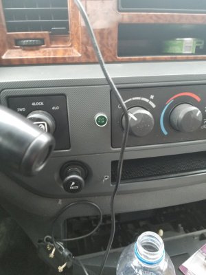

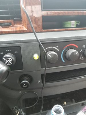

About the mds, does tow haul disable it? If so I could rule that out by driving in tow haul for a week. If MDS is the cause I’ll just let it clunk.
Yes it does disable it. Before I put in the light I could have sworn I still felt it kicking in but I think I was feeling the lock up torque converter. That is also something that could be happening. When it happens, how long did you say it lasts? What year is your truck? Also, make sure you're running the type of oil it specifies. For MDS motors it's 5w20. The MDS uses the oil in is deactivation process.
