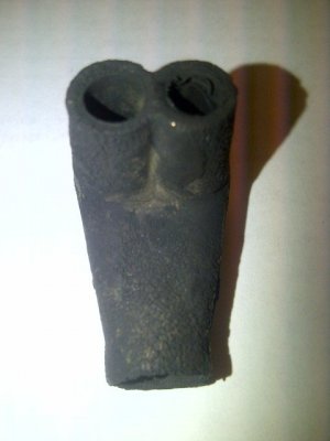

    thanks RedTruck, done alot of research and have checked lots of posts. lots of great info in here. still unsure if any of these pumps or nvld pump can be serviced or easier to just replace. Also where do you buy these special hoses? I have a two into one rubber connector that i cant find anywhere? who sells this special hoses. gonna see if i can attch a photo of it.....

    Blazintowers, did you ever find the vacuum tee you posted the picture of? Mine crumbled, and the dealer wants to sell the whole harness. Thank you!
