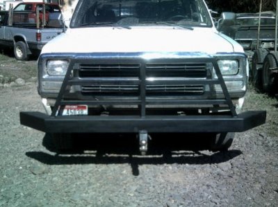

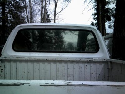

I have a couple pics of the truck when I bought it for a measly $500.

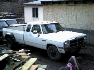

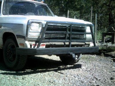

And here are a few pics after I had the truck for about 2 months :)

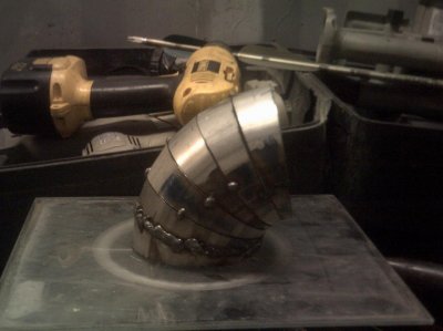

Here is a pic of the 90 degree hood stack elbow tacked together.

I had to add a thinner segment to the elbow to get it close to 90 degrees. I'm about 1-1.5 degrees off from 90. My 9" side grinder will take care of this issue XD

This is what the elbow looks like after smoothing out the welds.
