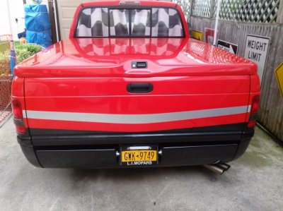

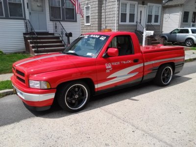

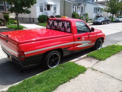

  4. EDDNIE
    EDDNIE Senior Member
    Posts:
    159
    Likes Received:
    92
    Joined:
    Jul 10, 2011
    Location:
    LONG ISLAND NY
    Ram Year:
    2009 1500 DEEPWATER BLUE, 1996 INDY RAM
    Engine:
    5.7 HEMI, 5.9
    Lowered
    Belltech kit
