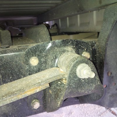

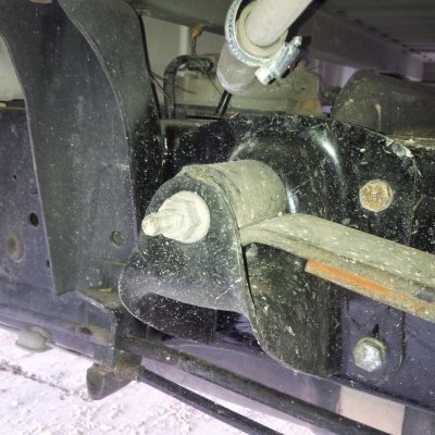

    I used the wrong wording, 2wd, the front spring hanger for the rear axle, knock out the rivits, flip the hanger, re bolt, and gain 2" of drop.

    Ok thanks for clearing that up for me.
    Tip; You will have to drop the gas tank to work on the drivers side hanger and leaf-spring bolt. If you have small hands and arm's you might be able to just loosen off the gas tank straps move the tank over and squeeze your hand between the frame and the tank (from the top that is).
    Edit: Keep an eye on your pinion angle it going to change on you when you do this.

    yessir, you also have to elongate two of the holes to get it to bolt up.

    I would not elongate a hanger hole, if there is room drill new holes in the hanger and the frame. Try and keep the new holes at least an inch from the old ones if possible.

    ok, so the ass end is done, this is 2" drop shackles and front leaf spring flip. im currently running 305/50/20's
