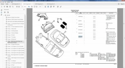

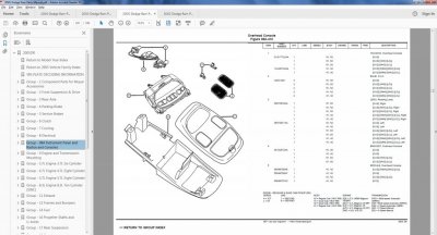

EVIC came in today and I swapped it into my original console for now. Looking at the 2 consoles, I think I can get away with drilling a couple holes in the plastic in the map light area like the smaller console has, cutting away some of the headliner and then be able to mount the longer console without needing the longer support bracket for it.

The longer console mounts differently, so unless you want the back end to hang down, you'll need it lol. It sounds like you have a rotating frequency door opener. There's a special procedure for that (it's in the manual).
