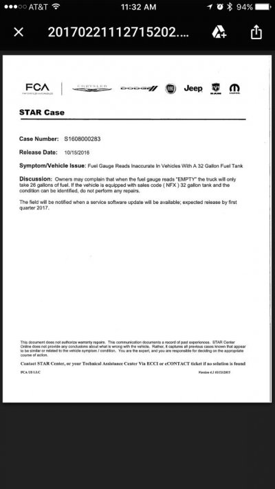

Hi everyone,
I was able to confirm that the brand is aware of this concern and is working to provide a resolution to customers as soon as possible. The tentative ETA for the fix to be released is during the 1st quarter of 2018 however this is subject to change. I will post any updates I receive on this thread, we appreciate your patience during this process.

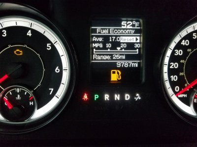

My truck on E with the light on, 26g tank.
Put just a touch over 23 gallons in.

Any update?
Any update from RAM about a software fix to address 32 gallon fuel tank issue?
RamCares
Jan 21, 2016
3,782
1,513
Michigan
n/a
n/a
Hi viper775,
Reposting what I said on page 2:
