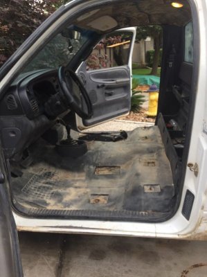

    Hey everyone..i hav 99 ram 1500,v6...base model truck has the bench seat...it is really bad...lol...i found a 40 20 40 seat( i believe thats what they were called) from a ram 2500..i took a quick measure between the two mounting bolts next to the door ..its the same in both trucks...the front and rear seat legs are staggered,the rear legs is shorter in my truck...appears the same in the 2500,but hard to tell with the carpet....bottom line..will they swap??? Looks like they will,but id prefer an expert opinion...:) any help appreciated....thanks much....both trucks hav non power seats....
