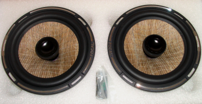

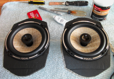

What a buummer, but think I know what is going on, the Focal 165F 3 way crossover is not designed to be bi-amped , shooting self in forehead ........... lol
Tomorrow I am going to hook up a mid base to the cross over to confirm my suspicion, if the case not sure what I will do, will come back to this

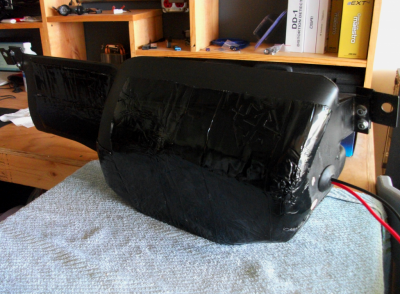

Setting the system to 2 channel input just so I could hear it, all I can say is wow, just jaw doping and my main concern was the sub in the factory box,
This thing hits so hard it hurt's, super impressed with this 8" and is everything and way more than the expectations I had.
the front stage even know they are only 6.5" drivers hit exceptionally hard as well, the sound deadening has seemed to have paid off big
The mids and highs are breathtaking, and surprisingly not as harsh as I thought they would be, but the clarity even on 320KBS data is super sharp and detailed

So I am really happy with the choices, just have to get this worked out up front.
Some input would be appreciated, the caveat is if I test and it works with the mid base in the cross over then there are choices to be made
Better off running the 3 way set on a single channel and leave one channel un-used or do I run the entire front stage active and buy a cheap brick amp to push the rear's
However the latter means I could not control the rears with my DSP , just the six front channels and the two sub chanels would be able to be controlled by the DSP
Any thoughts ?

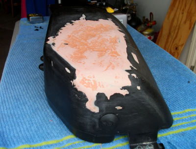

here are a few pics of the finished sub, sound deadened the interior and exterior for some extra strength and really deadened it up nicely
