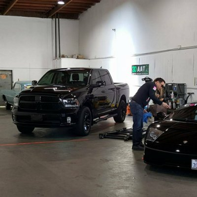

I'm considering doing a ceramic coating on my truck. Is this something easily done myself or do you recommend a professional? Is there a brand anyone recommends? My truck has 3200 miles on it and the paint should be in good shape. Although I will still use the clay bar. Any suggestions are appreciated.e8cd066a57d6ef16d3fefeb198d67c85.jpg

I would recommend getting the ceramic coating professionally done, unless you have the lighting and the tools to do your own buffing to remove swirl marks. My brand new 17' Sport had around 4000 and some odd miles when I had mine done and there was 15 hours of buffing (mainly on the bed of the truck to remove swirl marks). My truck was buffed head to toe and front to back. If you do not do any paint correction or buffing and there are scratches on your truck, the ceramic coating more intensify/magnify the scratches.

If you don't have the products or know how you probably better off having someone else do it.
Prep is everything when applying a coating. Wash, iron-X, clay, compound/polish, paint prep (to remove polish residue), 1-3 layers of coating, then most of them require a 12-24 hour cure time if you don't have IR lamps.
Some of the easier to apply consumer coatings are Sonax CC36, Optimum Gloss-Coat, Gyeon Can Coat, McKee's 37 Paint coating, Wolfgang Uber, Pinnacle Black Label Diamond Paint Coating v2, and the combo of CarPro Essence + CQuartz to name a few.
