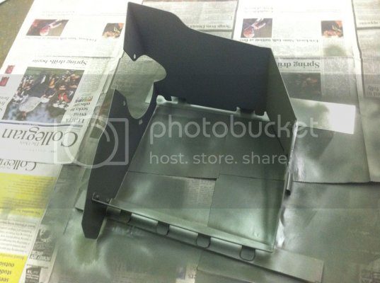

So here's the story

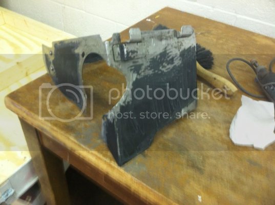

I've been planning to make a torque tube to teplace the stock one with baffles in it since I ranked the silencer ring a few weeks ago

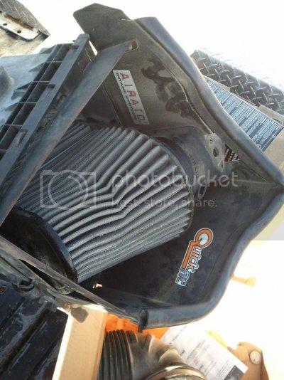

Found an airraid quick fit aibox with synthaflow for $50 shipped
It looked really dirty in the guys picture and was worse when it showed up
Didn't know the bottom was covered in rust
So I had another project on my hands but I was excited cause theres a bead blaster at school
Turns out its a *************

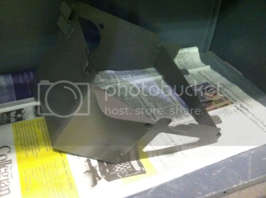

Got sick of waiting for my friend
Color matched and cleared
Hopefully I'll finish painting the airbox tommirrow and get it on Friday or saturday

Already got a quote from Dave a few days ago
The guy thought it was a dry filter which woul have been perfect
I'm glad I ran the part number and didn't just assume he was right
You can tell in the fits picture it hasnt seen a drop of oil do I've already recharged it

I finished painting, clearing and wet sanding today!
I wish it was another color then grey because it just looks like metal lol but both are now color matched

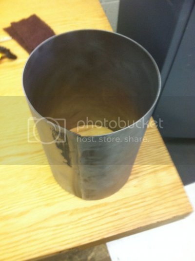

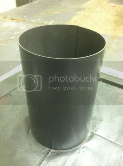

Should be able to get them in tommorow. I'm hoping and praying that the torque tube fits. I was shooting for 5.5" OD but no matter how I pulled the sheet metal from the roller it would flatten out a bit so when I welded it the best i could really get it to was like 5.62" on the bead but the rest is like 5.4"
I threw it on a hydraulic press and played with it some so now with paint its 5.55" at the bead/ largest OD so I think it will fit!
So how much is too much oil on the filter?
I've done my quads K&N filter but with that i pretty much spray the **** out of it and say F it since I clean it every other ride. This isnt nearly the same! lol Theres warnings everywhere that say not to over oil but how much is that exactly?
I went over it twice and its definitly covered well but its not the bright red you usaully see from these filters, any tips?

If you know anyone with a sheet metal roller I know your more then capable of makeing one too haha
I just got a sheet of 8"x24" 16ga steel from lowes for $13 dollars, sheared it to 17.25" and rolled it to 5.5" OD and mig'd it
Hell I could shear, roll and ship you one for cheaper then what they cost you'd just have to weld and paint haha

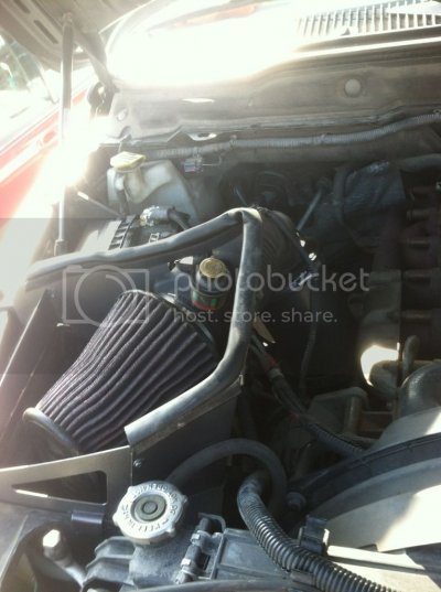

Installed earlier this afternoon
I put the airbox and filter in and went for a quick ride, didn't really notice much difference in the sound
When I got back I put in the torque tube I made
Here's why I replaced it!
You can kinda see it installed
Holy hell does it sing now!
The tube makes a hell of a difference in sound atleast
