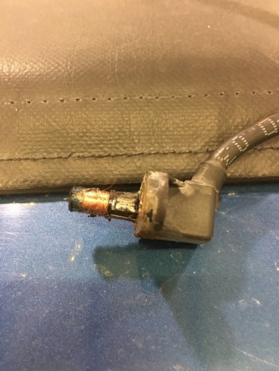

    I thought it was the same I remembered I did it in my dakota. But will it tell me one that hasn't triggered a cel yet?

    I'm looking at the diagrams, and if I'm reading this right, the front left sensor is the one that can kick off the cruise control without triggering an ABS light.

    It should show pending codes as well.

    Are the sensors in the hub bearing or a separate bolt on?

    They can be replaced separately, I think they're about $60.

    No problem. Just FYI for others that may look at this in the future, from my research it seems that this is a Hemi specific problem. For some reason, the other trucks are wired slightly differently which will kick a CEL or ABS light with a speed sensor goes out.
    Dodge decided for some reason to kind of leave the left front out of the loop on just the Hemi trucks in 2005.

    I have a pending p1501 code bullitt I'm going to clear it and see if it comes back unless you think otherwise

    That's what I expected. You can clear it, but it'll likely come back shortly. Left front speed sensor will be your fix.
