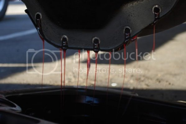

    Step # 2 Place drip pan under Diff, and start removing Bolts
    You need to remove the bolts starting from the bottom and work your way up. This will allow the fluid to start draining without making a huge mess.

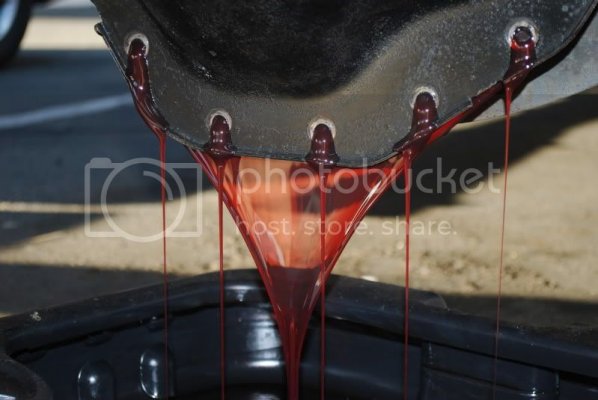

    Step #3 Allow fluid to drain and remove cover
    Wait a few minutes with only the top two bolts loosely in place for the rest of the fluid to drain out. Next remove your cover.

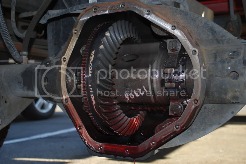

    Step #4 Clean out pumpkin/cover and inspect Gears and Gasket
    Using a clean rag wipe out all the excess fluid from the bottom of the differential. Use this time to inspect your gears for any abnormal wear or chips, or anything out of the ordinary. DONT USE CLEANER INSIDE THE DIFF!! you most likely wont be able to get it all out, and it could prematurely break down the viscosity of your new fluid. Next, inspect your cover gasket if equipped, and clean out the inside of the cover using the cleaner of your choice.

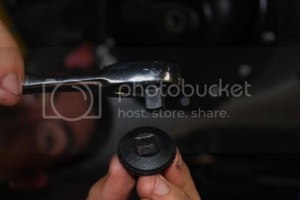

    Step #7 Fill Diff with Correct amount of fluid
    To take out the fill plug simply use a 3/8" drive socket wrench. Next fill with diff fluid. (my 10.5" rear took 3 quarts) fill until fluid is just below the fill hole. Next replace fill plug, and torque to specs (24 ft/lbs)

    I know this is an old post but I just changed my rear diff. fluid and the plug on the diff. cover is basically a rubber stopper. It fits pretty snug. Is this normal?

    Yes. It needs to be to keep the oil from splashing out or pouring out.

    So the one in the Pic up top is rubber also?? Cause mine dosn't have the place for the wrench. I just pryed it out with a flat screwdriver. Was under the impression it was a bolt or sorts.

    His doesn't seem to be, may be an aftermarket cover. But mine is.
