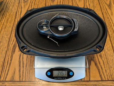

Here's a pic of the Pioneer and the stock speaker. I should have taken a shot showing the height of each speaker. The Pioneer is about 3/8" taller than the stock one:
Here's the Pioneer speaker being weighed. BTW, the stock speaker weighed 17.6 ounces. The majority of the weight difference is in the magnet.
