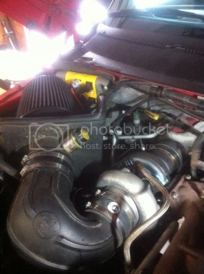

    Well after the turbo swap I noticed a drop in PSI at WOT ..
    Idle is 20psi
    cruising 17-18psi
    Now WOT 9-10 .. WTF ?

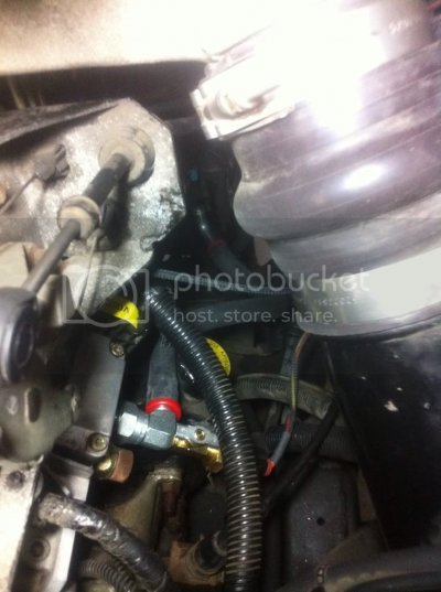

    Mike , I have the OEM line from the VP44 to the OEM filter .. And I cracked the raptor open and the screen was spotless . Ran the truck on #2 setting and same thing .
    I did notice that at idle it bounces from 21-16 and crusing is 16-17 but at WOT still drops to 9-10 ?
    If the fix is the new fitting ... link me to a place to get it .
    On a side note ... changed my T-stat and that fixed the putting it into drive and killing it thing at first start up . My gauge now reads 190 with hi idle within min 's

    yea, thats your problem. 1/4" difference
