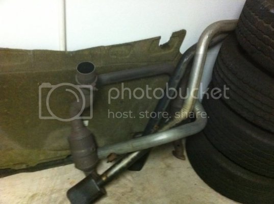

I have no idea what they're worth. But here they are.

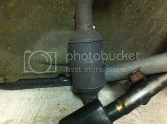

is that an O2 sensor port on the top of the cat? If so that is different from what the 05's have, they have the **** behind the cat, only hole in the cat is a small drainage hole (make sure when you install them that that is pointing to the ground or they'll rust). Not sure if the PCM will read right if it is taking the reading from inside the cat though since ours is designed to read from before and behind the cat.
