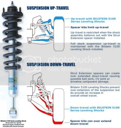

    Do you need to replace the Upper Control Arms when using the 5100`s instead of spacers because of the factory ball joint pop out situation that occurs on Ram 1500 trucks.

    If installed correctly, no Bilstein 5100's shouldn't require replacement of the UCA as the prevent the suspension from overextending which is where the ball joint pops out. As long as the Bilstein is assembled correctly and installed properly there shouldn't be a problem. I recommend unbolting the steering knuckle from the upper ball joint for install to avoid overextending it during install when you put the strut assembly back in the truck.
