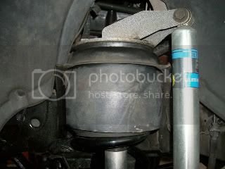

I was looking at the LA setup in the pics, and can't really make it out (brand-wise.) I know it's not an Iron Rock, and most of the FabTechs I've seen, usually have the bushing-end of the arms gusseted. not to say this couldn't be an earlier rendition.
those front coils look awful skinny wire diameter, too, after looking at my 2500's front coils. :)

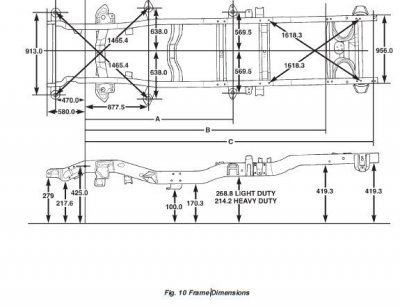

I really need to find the hub to fender #'s for a stock truck. I'm going to ask some guys a work, a few of them have 2500's.

Best I can do for you, at the moment... (measurements are in mm. Ex. 279 mm = 10.9842 ")
1 millimeter = ~ 0.04 inches

I would say its not a Fabtech. Old Fabtechs are "psuedo long arms" like skyjacker. They relocate the lower arm but the upper has brackets that bolt to the differential.
I wonder if its and old style .... what the heck is it...crap! Brainfart!
BRB... I'll find it!
It looks like Trailmaster long arms... but it looks like you have cam adjusters in the back mounts. Is that correct? I know they used a non parrallel long arm kit on thier 4 inch lift but I haven't seen one in many years.
Is that a cast aluminum or Steel spacer? *** do you hava pic of the trackbar set up?
That spacer is a nylon block, like a body lift spacer. Yes it has cam bolts and here is a pic of the trackbar set up. Coming from XJ/ZJ 's I'm familiar with the front end just unsure of the lift.
