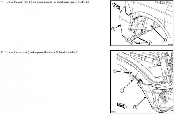

First, bumper has to come out:

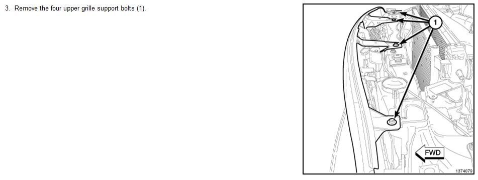

Step 4 there says to remove the grill, so here's their instructions on that:
