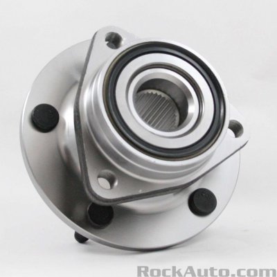

    While rotating my tires today I found that the driver side hub bearing sounds "not normal" there is no play yet but the passenger side is silent when I spin it.
    Seems you have to replace the entire hub assembly.
    Is it as straight forward as it looks, are there any hidden bombs I should be aware of?

    Ok guys I'm finally getting around to changing out the hub assembly. After finally getting the 3 mounting bolts to break free using a 3 foot cheater pipe I had to order a 43mm socket for the spindle nut because nobody in my small town had one.
    My question is whether the axle shaft is going to be frozen onto the hub assembly and if there is a trick to getting the assembly off the axel?http://www.ramforum.com/attachment.php?attachmentid=81652&stc=1&d=1482367127

    Its a Dodge invest in 5lb sledges
    but getting the unit bearing off the knuckle is the hard part. Cover that bitch in antisieze to save your life when you do ball joints. Axle shaft is usually fine.

    :)Well I finally got it done. I broke 2 half inch ratchets, my tourque wrench and my breaker bar trying to get the castle nut off the stub axel. What a pain in the ass. The two auto parts stores with loan a tool programs did not have any impact wrenches.
    A guy next to me heard what I was doing and asked where I lived and then he told me he lived about 3 blocks from me and would be right over with his impact gun.
    He came over and zapped the nut off in about 3 seconds. He showed me where to give the axel a good whack to break it free from the hub and not screw up the threads, he knew how to get the hub off the knuckle pretty easily. We put the new hub assembly on and he tourqed it down all in about 20 minutes.
