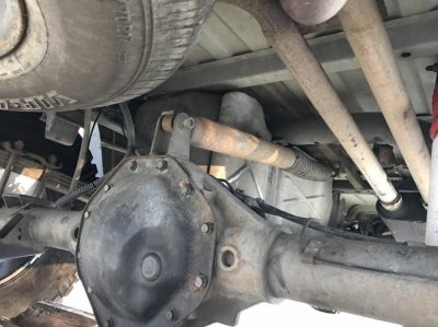

    It's a shock absorber that mounts to the top of the dif housing and goes to a mount on the frame
    It's supposed to prevent axle wrap and wheel hop and just generally improve handling.
    I replaced all 4 shocks recently and couldn't find a part # on this so hoping one of y'all would have gone through same process
    Here's a pic
    Thanks

    You're best bet would probably be too measure it and maybe write a shock company and have them get you a part number of similar size
    That an eBay exhaust kit?

    Yeah maybe I'll swing in to 4 wheel parts and ask them... I'll try to measure tomorrow...
    As for exhaust idk, I bought the truck with it on there had a pro-flo 2into1 and sounded terrible
    So I replaced with supper 44
    Much much better

    Ok so update for whom ever wants to know
    Apparently these came factory on the Srt Rams or at least the Reg Cabs, I think for those of us who run lift kits most trucks now use ladder bars or lateral Track bars to prevent rear axle play forward/reverse. I guess the guy I bought truck from decided this would be a good mod .... oh well guess I'll just order another Pro Comp shock to replace the one that's there
    Here is some info from vipertruck.com
    If anyone cares here's the link
    Scroll all the way to bottom
    https://theviperstore.com/RAM-SRT10_Products_Parts&Upgrades_Replacement_Parts_Shocks.htm

    I've found a couple Srt forums where those guys swear by it ...idk
    I have it so I'll replace it ...may drive around with out before I install new one to see if I notice any difference
