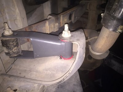

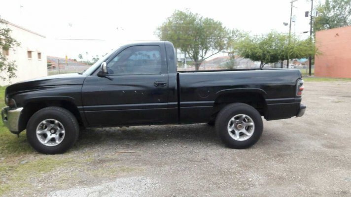

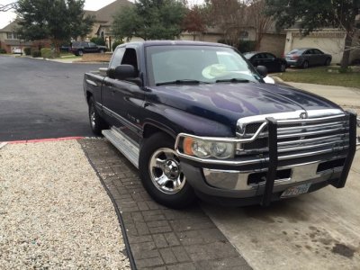

    I'm new to lowering vehicles and I got this truck which I would like to lower the rear. Currently the space between the tire and the body is 8 inches on the rear and 4 inches on the front, my goal is to have them both on 4. I've included a pic to make it easier to see. Will shackles alone achieve this or would I need to buy the leaf springs too?

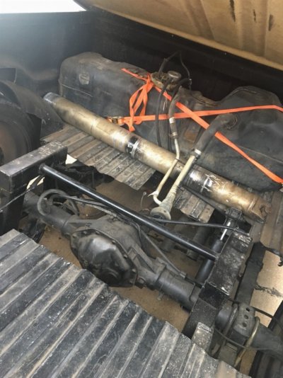

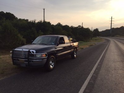

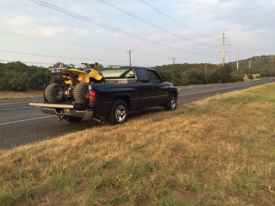

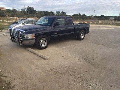

    I had a drop of 3 in in front and 4 in in the back, I had to swap back to just a drop in rear due to my grandparents mostly using the truck now. Here are some pics of just shackles.

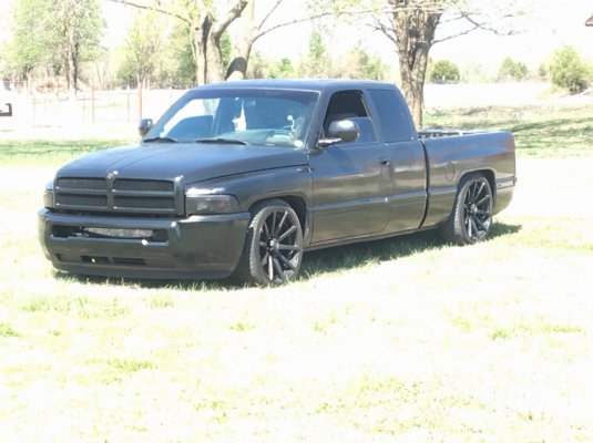

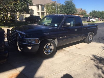

    Here are some more pics of when it was fully 3/4 drop.
    If you want the nitro drop 2 shocks I have them brand new in box (never installed) and the shackles used for about 10k miles pm me.

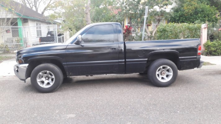

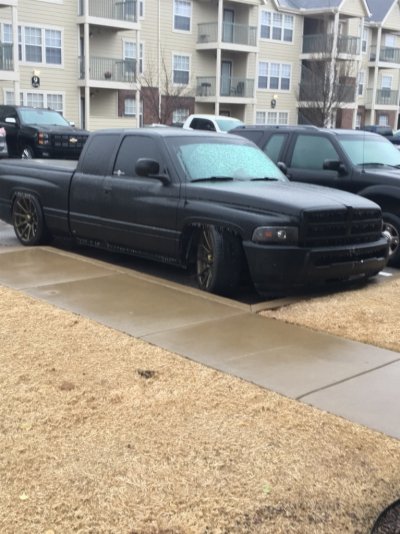

    Ok so I just installed the lowering shackles for now and I can't see much of a difference. It did drop an inch, but they were 2" lowering shackles, is this normal? And yes, I did use the highest hole.
    Here's a before[​IMG]
    and here's an after
    [​IMG]

    I believe that is correct, all brands are different, and may achieve very minor height differences. Did you measure before and after?
  10. goodtodoo
    goodtodoo Senior Member
    Posts:
    130
    Likes Received:
    13
    Joined:
    Jul 17, 2016
    Ram Year:
    1996 indy pace truck
    Engine:
    5.9
    Ya that about it with the rear shakle only. When I did the Bellteck 2x4 drop on my sb 2wd, I installed only the shakle with the 2" drop spindles up front and the rear only dropped an inch or so. So then I put the spring hangers on, and the rear came down another 3".
