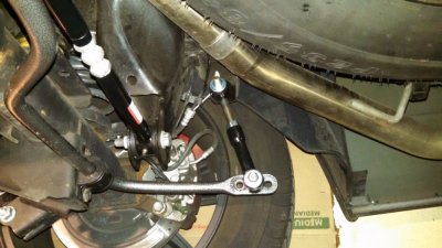

You are going with adjustable control arms to center your axle, right? They are some of my favorite parts on my whole truck. People always ask me wtf they are.
I think I told you about this before, but remember to get the delrin bushings for the control arms, it's very important. You'll need to call the order in to Spohn, because I still don't see them on their website.
