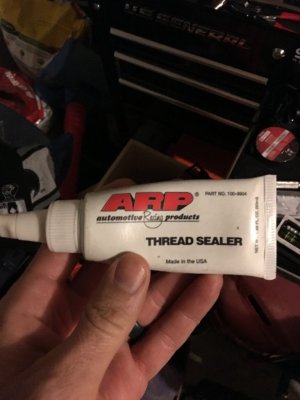

I will also add for the threads I used the ARP thread sealer on the Fragola fittings. And a little goes a long way:
Part/serial 100-9904 is what you would use in your search on Amazon or EBay.
