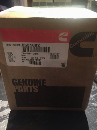

Had both recalls done on my truck yesterday. I had actually called them because I wanted to schedule them to put on the water pump I got from Geno's. I figured, hell, it's a recall, why should I do the work? Anyway, surprise, surprise, of course now they have two water pumps in stock so they held one for me. They did change mine so it must have been one of the "bad ones" and they did the T-79 recall also. So, now I have an extra water pump. Anyone need one? Or maybe I should just keep it in case of a future problem?
