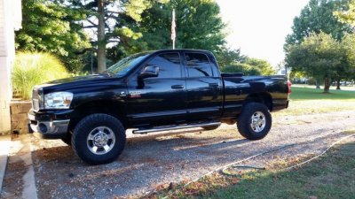

    I have a 2007 with the 5.9 Cummins. I ordered a Fortin CHRT5 remote start, with the flash link updater & the Directed Electronics Smart Start, so that I could use my cellphone to start my truck. I will be installing it tommorow, and will update here if anyone is interested in this kind of setup. I have just over $200 in it.
