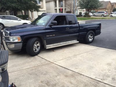

    This is a picture of mine with a 2/4 drop with the hanger flip in rear.
    Beauduke has this set up as well and so does dodgedrew.
    Let us know if you need anything.
    Together we can do a whole lot with these Mopars.

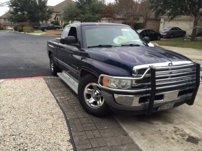

    Thanks gotter done today trying to figure out how to post pics bare with me,Started this wanting 4/6 Ended up with a 2.5/4.5 got pissed used yalls hanger flip,lower shackle from AUTO ZONE $39.95,cut exactly 1 coil off and it turned out fine,Thanks for all the help and schooling learned and saved LOL i will try to post all step by pics asap

    01 ram 2/4
    fixed
