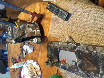

    The Visors are held together buy some kind of Foam adhesive. I used a hobby knife to slice it down the middle and opened them up like a clam shell. Used a Fabric Glue I found in the house to put the new fabric on and then used Gorilla Glue (#HarambeGlue) to put it back together because it is a high expansion glue. Be sure to use plenty of clams when gluing it back together. Mine are going on 1 year and still holding great.
