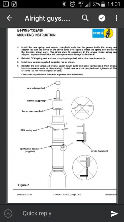

I called the mechanic and asked if there "is any possibility" that the top nut has let off and become loose but he advised "No", it was torqued and tight as hell when he buttoned it all back together. I imagine the ride would be much worse if the spring seat was installed improperly.
Can anyone else relate to this / any advice? I would like to check the nuts myself but cant really figure out how exactly.
