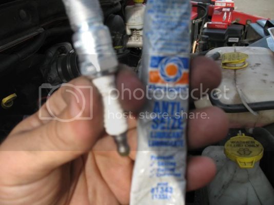

    nah, you dont need to worry about anything. Just make sure you use anti-seize when putting the new plugs in. Other than that, it's straight forward :)

    If you are changing like you are supposed to every 30k no point in wasting time with antiseize. If you want to go ahead though. It is actually easy just a bit of a hassle just make sure you have different length extensions and it is a breeze.
