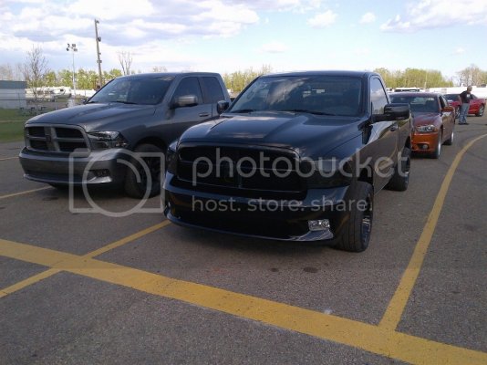

Ground Force 2/3 Drop, 10' RCSB Sport 4x4
305/50R20 Terra Grapplers'
Before/After
Plasti Dip'd rims for winter
28" Drag Radials for the Track
ALL four of them for Supercharger Traction ...
You sir have a SWEET looking truck!

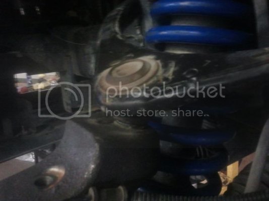

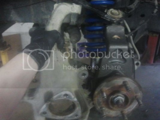

You can lower a 4wd with the McGaughy's spindle kit. It does put more angle on the upper ball joint and you may have CV joint issues. I have issues, but that may be becuase I'm also running the 2" GF drop springs.
This is interesting! What were your measurements with just the ground force kit? What are your measurements now running the McGaughy's spindle kit and ground force springs? What year is your truck? Did you have to modify the spindles in anyway? Sorry for all the questions...just very excited to see this :head3:.
It's an '09, and I wouldn't recommend anyone else go this low unless they're willing to spend the $$ to do it properly. I did everything all at once; I was waiting for a new engine tune after I did my engine swap and s/c install and I was paying for the lift by the day, so I figured I had to make hay while the sun was shining.
I'm now 4" down in the front with the spindles and GF springs, and I used the 2wd rear springs from the Mc'G kit with a set of 2wd Belltech shocks, so it's about 6" in the rear, it's currently got the oem bumpstops jammed so far into the mount it's not funny, notch kit should be arriving on Monday.
I didn't see a need to take anything out of the spindle as I haven't seen any contact and clearance looks good, but I'm keeping an eye on it since others say they had to take a bit out of the backside. I've had the one CV pulled since I destroyed the inner joint but the truck has only been moved around, never really driven so far.
I'm correcting the upper balljoint issue by installing MMW upper control arms that run a uni-ball joint, but I'll be keeping an eye on my alignment incase I need to get a custom set built with adjustable arms. And I'm trying out the Kore high angle inner CVs to see if they'll hold up before I'm forced to get a custom set of CVs shafts built.
