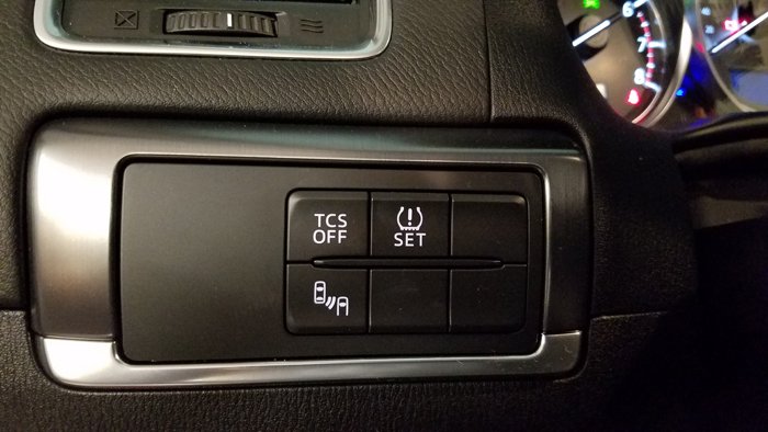

    I don't want to say you're wrong but...
    [​IMG]
    nukegm likes this.
  9. reloaderguy
    reloaderguy Senior Member
    Posts:
    413
    Likes Received:
    168
    Joined:
    Apr 26, 2015
    Location:
    Oregon
    Ram Year:
    2016 Power Wagon
    Engine:
    No they didn't. FCA decided they didn't want thresholds changed. I can change the thresholds in my wife's car.
