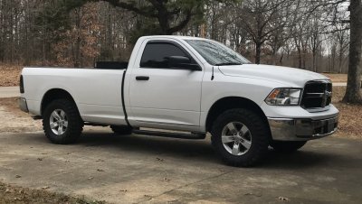

ADMIN- please move this to whatever thread it needs to be in. I have a 2016 RAM 1500 4x4 Tradesman regular cab long bed with factory 17" aluminum wheels, 2" front leveling kit, currently has 305/65-17 AMP Tires (new), no other modifications. The question is this, I have tried different sizes, different brands and different tread designs, the truck has just had a fresh alignment. I have a terrible vibration from 45mph up but it seems to synchronize on and off after say, 58mph. I have tried different wheels too. Seems to be coming from the rear (again seems to be). I do not feel vibration in steering wheel, but the console and seats rattle when the vibration is going on. I tell you, its bad enough you cannot take a drink of soda, anything in the cup holders rattles and nearly spills out. We (the tire shop) have tried different tires, different wheels, the fresh alignment today, and it still does it! We are chasing a rouge vibration! I guess Ill take it back to the dealer but they will take days to find something and I really doublt with just under 18000 miles they will admit to anything! Has anybody got any suggestions on what to check? I am going to chech the drive shaft and ujoints tomorrow! It did not do this with the tiny factory Goodyear Wranglers but I hate Goodyear's
