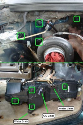

  9. dudeman2009
    dudeman2009 Senior Member
    Age:
    22
    Posts:
    1,395
    Likes Received:
    157
    Joined:
    Feb 9, 2016
    Location:
    Lansing, Michigan
    Ram Year:
    2001 1500 Sport with enough electrical modifications to make my brain hurt
    Engine:
    Magnum 360
    Marksman is pretty spot on, except you DO NOT reed to touch the airbags, you can work around it.
    There are four on the steering column
    The screws along the windshield, six I think.
    The two plastic kick panels on the outside of either footwell hide one large nut on each side
    In the center under the cupholders behind the plastic cover there are two bolts, one on either side.
    Then start pulling the dash back on the passenger side, this is a long process as there is a large wiring connector in the center on the floor that needs to be disconnected, as well as some connectors behind the passenger airbag (you can get to those by just reaching around as you pull it back. you will be going from one side to the other to schooch it out inch by inch until it is comfortable to work behind.
    Marksman has a great idea, something that I only figured out halfway through, take a ratchet strap from the dash and hook it to the rear door roof latch if you have the suicide doors, or run it out and hook it onto the lip of the bed.
    There are two nuts on the inside behind the passenger airbag, there are four in the engine bay. One is behind the PCM, another is behind the A/C accumulator, the other two are on the firewall. On the V8's there is a 5th nut in the very center behind the intake, do not remove that, that is for the air plumbing, that can stay.

    V10
    Thanks for clearing the air bag thing up. I had to pull it to install the new dash.
    I'll have to say, I don't recall unhooking a large electrical connector at the center of the dash, just the few for the airbag, blower and blower motor resistor.
    So you're saying I didn't have to take that nut behind the intake off? Damn.
