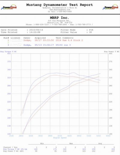

The only stock dyno charts I can find on a Ram 6.4 are from K&N (293hp/269tq) and MBRP (316hp/320tq). Obviously dyno's vary and K&N vehicle was a 3500, not that it should matter much. But regardless it's pretty obvious that the exhaust mods are giving huge HP and TQ gains over anything else I've done so far.

Will ask the shop what model Dynojet they use. The K&N is apparently a Dynojet but looks like they actually made a run in 2nd gear, which seems odd. Perhaps this is how they got the gear to hold and why the #'s are so low. The MBRP was a Mustang Dyno but I don't have any other info. Not sure I understand why the inertia dyno would hold a gear better if it was the factory programming causing it to downshift at a specific RPM. Will have to research that one a bit.
K&N
http://www.knfilters.com/dynocharts/77-1568_dyno.pdf
MBRP Chart

Older DynoJet dynos were strictly inertia and newer ones (I think 2005 and up) come with an adapter for eddy current. So a Dynojet can be either or depending on how old the unit is and the model.
The K&N Dynojet can still be an inertia dyno, but might be factoring in the weight depending on the model and how old it is. Dynojet makes different models and how accurate and versatile(range of vehicles weights and power) was depended on how much money you wanted to spend. I would wager that K&N probably got a higher end model that is probably newer as well.
An inertia dyno should not be able to hold a gear better especially if the roller is not calibrated for a heavier vehicles. Eddy current or load dynos are able to hold gears better because they provide a load allowing for a good torque converter lock up and boost in FI engines. Without a load or heavy enough roller resistance on an inertia dyno, you will have a hard time getting the torque converter to lock up in lower rpms making it just about impossible to get a low rpm reading.
