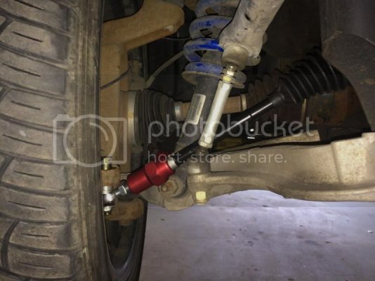

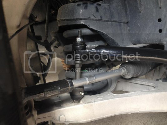

Saw this thread over on the Z forum and thought I'd share the info here. This mod will get your front sway bar more parallel with the road, which seems to improve steering response and ride. I installed the shorter end links today on my lowered '14 R/T and have to say it's a gerat mod. The end links are for a 2wd Ford F-150. I ordered Moog K80337 end links from Amazon for $30 a side. The only thing I did diffrent from the others was use both the factory and Moog supplied bushing cups because the Ford end link has a longer non threaded shaft that doesn't allow the rubber bushing to get enough preload. You can see what I did in the last picture. I "barrowed" a couple of pictures from the original thread :naughty:

Brand new from parts supplier of your choise!!! I bought Moog replacement end links, Moog part number K80337 off Amazon. Some of the guys on the RamForumZ were getting parts off eBay for less, but when it comes to suspension parts I'm spending the extra money for a quality product!

No, this is for lowered trucks only; the endlinks are the same design, they are just shorter to keep the sway bar properly aligned which will get the cornering stability back closer to stock. They aren't an improvement over the factory design, just a corrective change, well, except for the grease fitting.
I still prefer my Chris Alston endlinks because they remove the rubber bushing and allow for a higher mis-alignment than the stock design, but they're also $100 a side.
