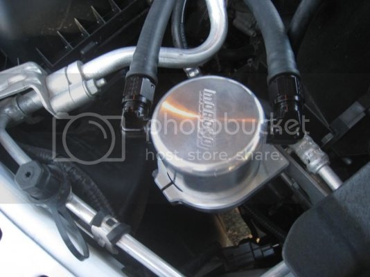

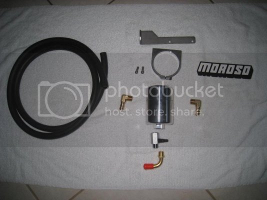

Here's another catch can install. I decided on a Moroso unit. I use Moroso products on my muscle cars, everything they offer is nice quality.

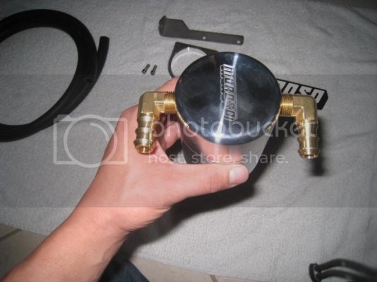

One thing I didn't really like was the brass fittings these catch cans come with so I used XRP -AN fittings and pushloc hose.
This is something totally unnecessary, but when it comes to -AN fittings and pipe thread, I ALWAYS open up the pipe threads so the -AN fitting screws all the way in. This step is more of a looks thing rather than performance.
You can see here the XRP forged 90's screw all the way in now as apposed to the brass fittings in the previous pic.
I also used an Earls billet hose separator to keep things tidy.
Many ways to skin a cat. LOL

Thanks for the kind words everyone.
I like both the BT and the Moroso catch can. I simply chose the Moroso unit because I use other Moroso products, and they all have proven to be of great quality.
I noticed many people use the BT catch can on here as well, I thought I'd be a little bit different and go with this one instead. Maybe even up the playing grounds between the two...
I got it from summit, this one:
http://www.summitracing.com/parts/mor-85479/overview/
And I also had them price match Lightning MotorSports:
Moroso 85479 Air Oil Separator - Dodge Ram Truck
saved about 15 bucks..

Just an FYI,pipe threads are tapered.
They aren't a standard straight thread,so you have to be careful opening the threads up with a tap.
If the fitting bottoms out in the threads with-out the jam factor from the tapered threads,you could possibly have a leak develop at the fitting,that'll need a pile of tape and or pipe dope to seal.

You are absolutely correct!
I used the proper tapered pipe tap for this job.

To stay on topic instead of just bash other people, to the OP, Im really digging how you didnt miss a detail and went all out with the tapered tap and all. The black fittings really set it off IMO, now i may have missed it but did you purchase black fittings or paint the supplied ones?

Mopar_Express,
I used XRP -AN fittings for this job. My local speed shop carries this brand in stock, but they are one of the more expensive brands.
When I have a big job that requires the use of many -AN fittings, I shop at Summit for Fragola. They are also a high quality fitting, but a few bucks cheaper per unit, which adds up fast.
