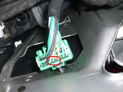

The power shut off on me this morning while making this post and I just noticed that I had accidentally posted this in the 3rd gen forum, i meant for it to be in the 4th gen DIY.
Deereguy, what colors or pins would be for the CHMSL Camera in the green connector?
The easiest way to tell is that the truck side connector will have an unshielded wire in it. See image below
