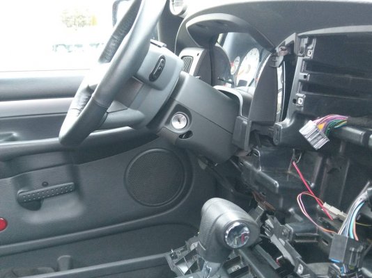

Kinda hard to see, but I accidentally discovered the silver cruise switches from an Aspen (that go quite nicely with the silver accents throughout the interior) so I put those in after I removed the column shifter. Need to find a non-column shift shroud (shouldn't be too hard).
Pulled out the old shift cable and ran the new one for the console shifter.
Gonna lay down some sound deadener and start cutting on the dash to fit the console tomorrow, then I can locate and attach the brackets. Probably run the wiring for the tailgate up as well.
