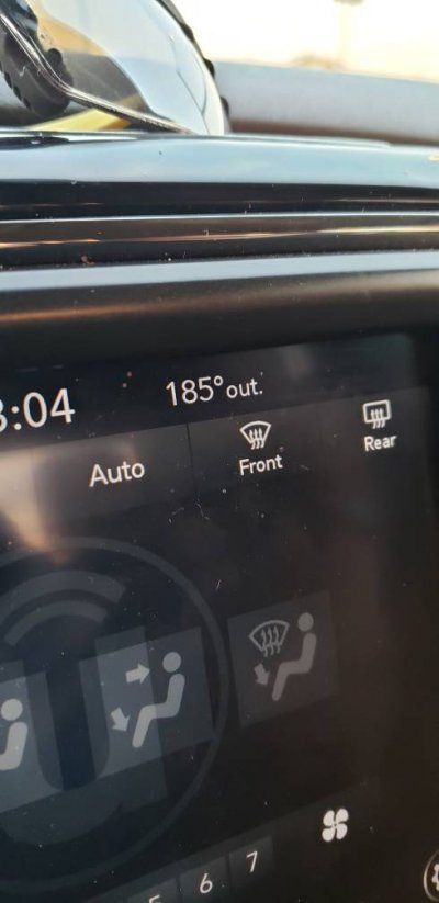

Anyone possibly know what setting I changed. I am getting ambient temp sensor error with check engine light. 2c397de68115daf3ac7211d2a14c7eff.jpg
For what it's worth, that is the way my 8.4 looked a couple weekends ago when I was on my final performance pages quest. Did you always have the "U" (Uconnect) background on your screen? When I made the changes in the vehicle line/brand, my screen looked like that and my temperature settings were off as well. The radio looked like it went back a few year and had no set programming if that make sense.

Anyone have time to send me your settings you show for ambient temp settings, sensor yes or no, and location. Also any settings you may have on a humidity sensor, location and type. I changed out mirror, installed smartbeam autodim assist mirror. I have power, but something is messed up. I have check engine light and outside temp displays 185 on my Uaq radio. I have 2017 Express and tested my old mirrors just to make sure there is nothing wrong with sensor.
I messed with the same setting back around post 1707. All the configs that I've seen have the ambient temp sensor present to no, and that will default the location setting to undefined. To correct my mistake I had to set my config back as stated, then clear the bcm faults, drive the truck until it popped a cel, park it with key in run and engine off, and clear the two faults with my edge monitor.
