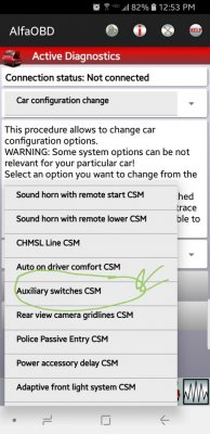

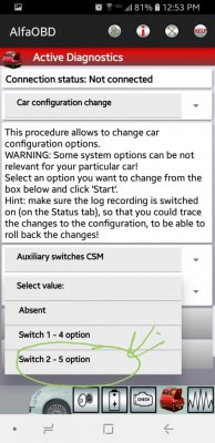

You just have to enable the Aux Switches CSM and it'll show up. I only had 4 show up initially, but then I did THIS and switch 5 showed up. There have been mixed results on some trucks in getting all 5 switches.
I have not been able to find the "Aux Switch CSM" Is it under BCM or what?
