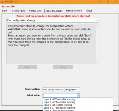

Checking to see if others have this problem.. switched from the TPMS to the TPIS on my truck a couple of weeks ago, everything worked fine, cleared the low tire pressure light. Noticed a couple of days ago the tire pressure screen doesn’t show up in the EVIC anymore, cycled thru the screens multiple times but doesn’t show up any more, I guess ill just set it back to TPMS and adjust the pressure levels.

I have not messed with this but I believe it all depends on what you select. I don't believe TPIS gives you the detailed section on the EVIC. Maybe select "Logic 2" or "Logic 4"?upload_2018-12-20_14-4-20.png

It was a screen in the EVIC for a time, but Ill give your suggestion a try and see what happens..

I haven't had to mess with mine yet or probably won't depending on whether or not I change something up. Could be it just took a while before it disappeared like some settings take longer for the BCM to set the changes.

Leaving it at TPMS and adjusting your thresholds give you the information you're looking for, and a warning when you are actually running low. Set it at 20psi and you'll never see that light unless needed.
Just my opinion, I'm sure you have your want of TPIS only for a reason. Just throwing out conversation.
