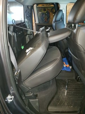

This is my Ram 1500 2017 QuadCab with rear seat of CrewCab.
Use the bracket of the QuadCab with Seat of the CrewCab.
2 in 1 for tilt the seat up and down !

I have one in the back of mine also,I also swapped the brackets.Problem is the back of the seat sits to straight so you have to lose the head rests for someone to sit there and there is zero
lumbar support,I bought the lumbar cushions to help.

Slightly,I'm going to try and find quad cab leather seat and swap out the back part,

Yes the headrest is straight.
I have 3 children. So, for me its ok.
