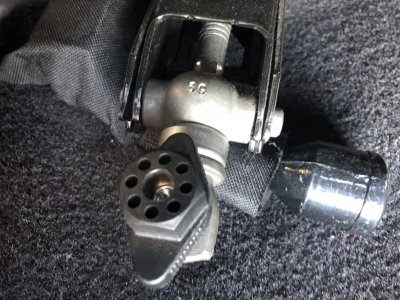

So what year did they make the change? I'm asking because my truck is a 2017 and it already came like that but OP stated 18+. Not that it really matters just curious.

yours looks like his last pic?.....unscrew the wing and see if its a female with a stud that remains in the truck, or a one piece like in his first pic.
Mine is a 2017 and I had the older style
I think so. Here they are lol
