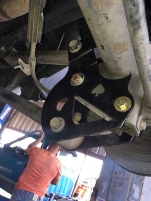

I don't have a wobble. I had the truck up to 90mph recently and it was pretty smooth. The problem I've run into has been the wheel and tire balance. I ordered wheels and tires as a package from on online vender and put them on right before the drop. They were shipped "balanced" ready to install. I found out that was not completely the case. Long story short, a couple of balances later finally at Discount Tire and the "flutter" is almost completely gone. I forget the exact verbiage he used, but the Discount Tire service manager said with all of the weights off, the tires were throwing the weight almost to the limit and he'd say that they are almost a bad set of tires.
I was afraid that the little bounce in the rear as in a little flutter feeling was what you guys were talking about? I haven't had any side to side wobble or sway. However I can attest to one of there other guys who left a post. If you are going fast with this kit and hit a bump it is going to be sporty....
